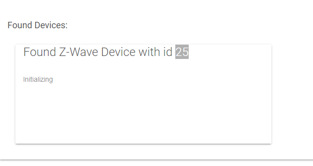

I see a new device but it is stuck at initalizing. Does not appear to want to pair

It never excludes and this is what I keep getting when I try to include
45%20PM
No Idea what is the issue, it just wont pair. Thanks for your assistance
