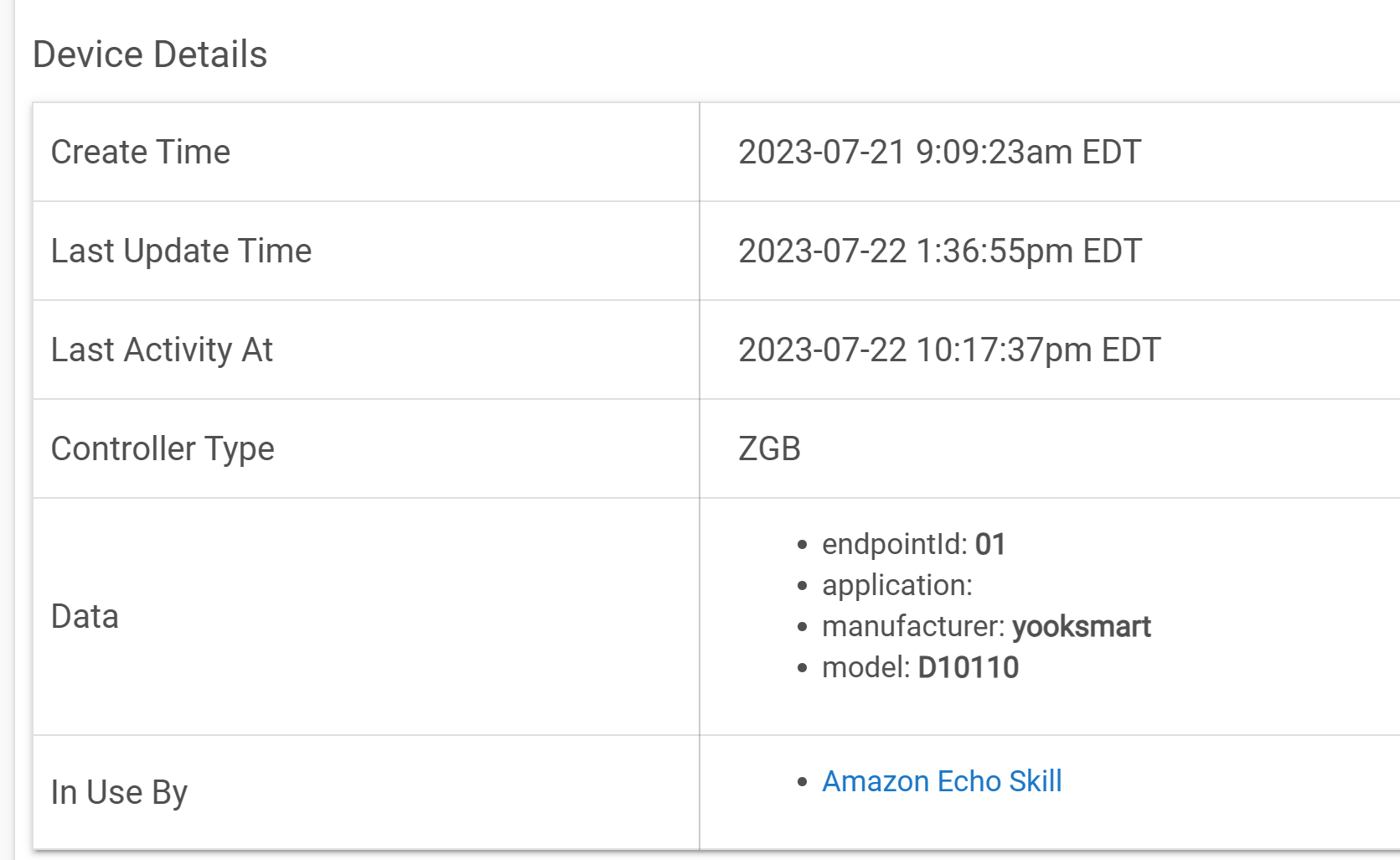

What I did notice is that in the configuration of the working shade, I can see a lot more information in the "Data" section under "Advanced" - see the screenshot below:

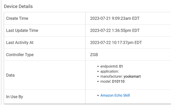

The new shade gives me much less information in the "Data" section:

Ok, I am resending the screenshots below, let me know if you can see them.
These are the details of the original shades that work:
These are the details of the new shades:

Per the second screen shot, while they did join, initialization didn't complete correctly.
Okay, so they are using the newer Yolax Zigbee driver as it automatically selects this driver once the pairing is completed.
What is interesting is that when I tried repeatedly removing and re-pairing the newer shades until they worked I immediately checked the details to see if they had changed and were showing more info and as of last night, both were the same as the second screenshot in my prior post which is why I was confused.
This morning, however, I just checked to send you a screenshot and now I am seeing the detailed info:
