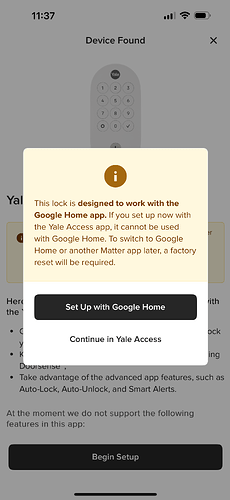

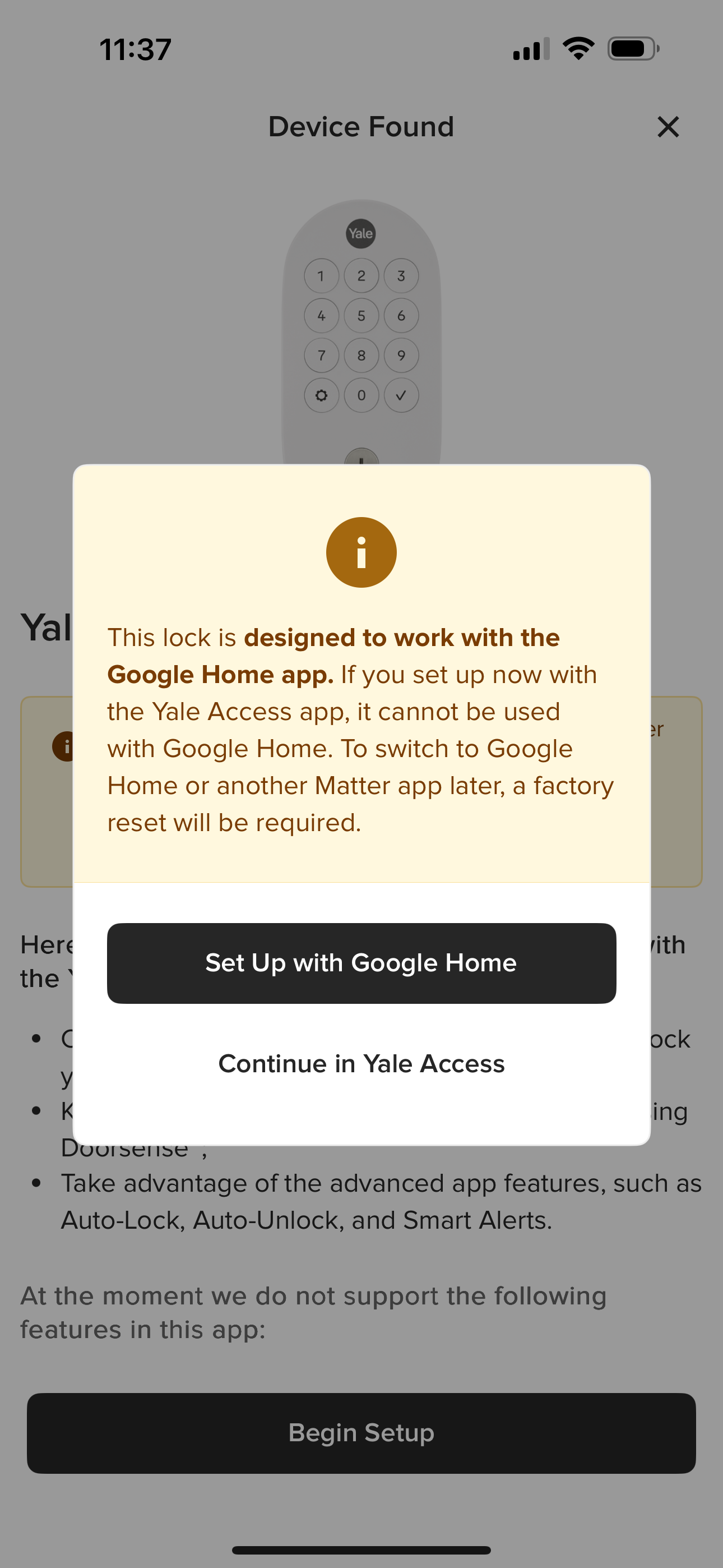

This lock can't be used with Yale app if it's provisioned using matter which leads me to believe that they would expose the commands. Is there a way to test this manually? I'm also new to matter. I'm trying to mess with until it's mature enough since it's suppose to use less battery and with my remote locks at various properties is very important.
Test what manually? Setting lock codes? As @mike.maxwell indicated above, settings lock codes is not exposed to Matter.
I never tried using the yale app with this lock, I use it with the other yale locks that are bluetooth enabled (with z-wave modules), are you saying that you initially connected and setup this lock using the yale access app, then added it to Hubitat, and that disabled bluetooth presumably?
Interesting, not sure why Yale did it this way:
Yea it requires Google home I think for the bridge to initialize. Then I can add it fine to hubitat but seems odd that the set code ls wouldn't work.
