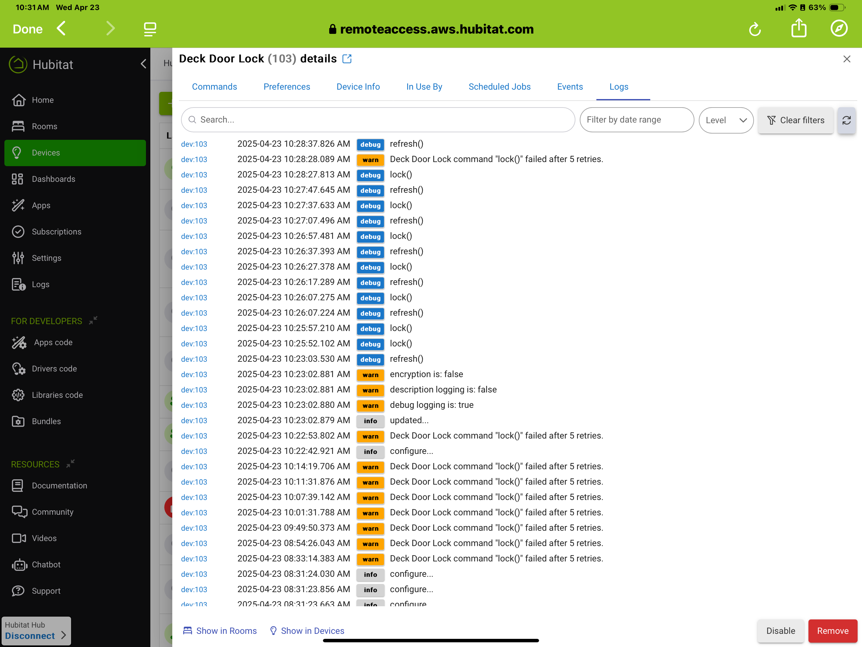

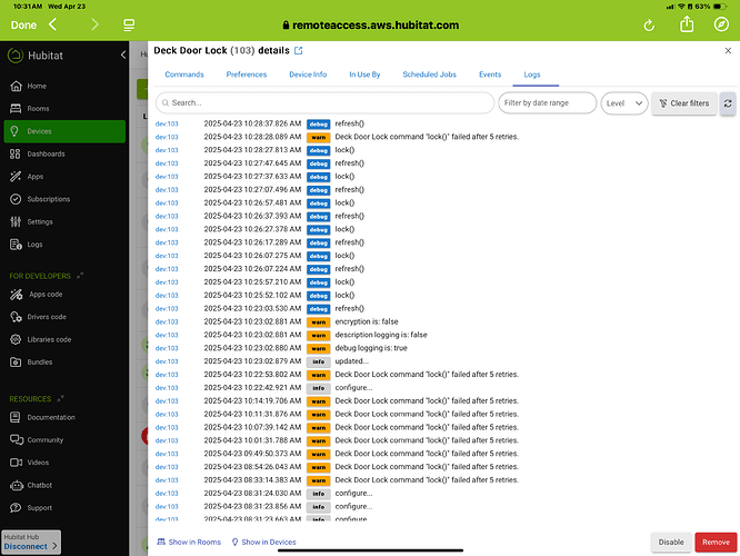

Thank you. Every command being sent is recorded in the log. The batteries are Duracell and have tested as fully charged. I’ll unplug for 30 seconds and see if that helps.
That does not really tell you much of anything in regards to connectivity. Thats just the driver debug logging saying you ran the lock or refresh command.
Most definitely looks like the lock is not talking to the hub at all in its current state.

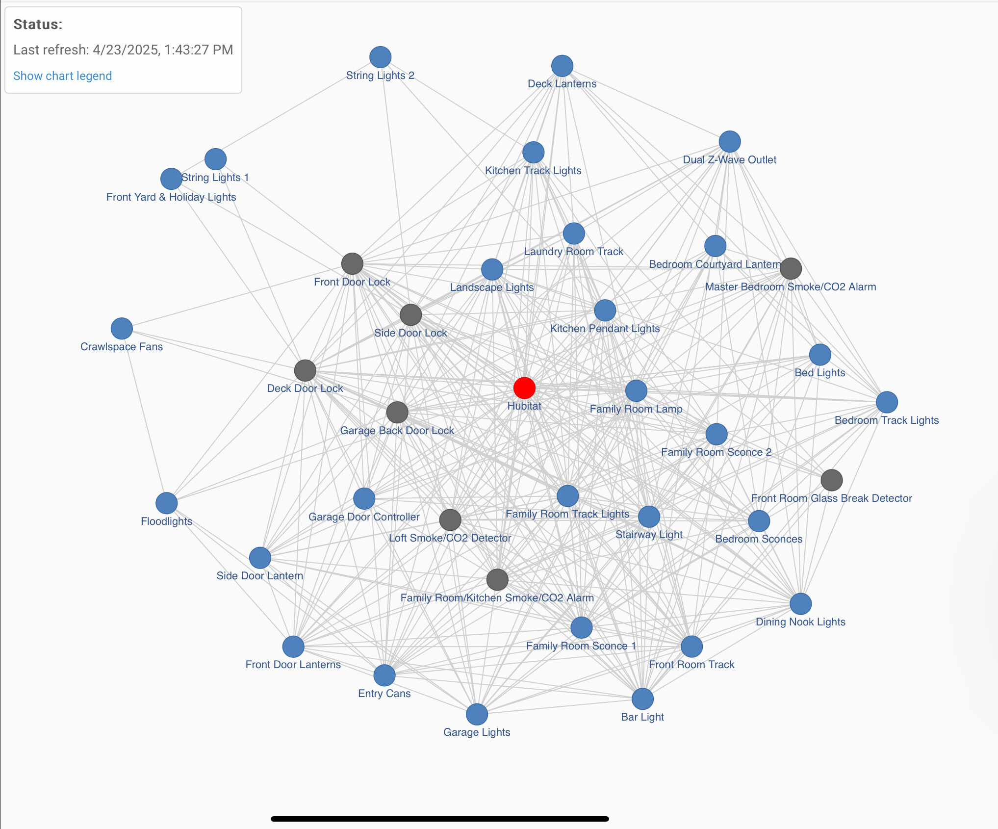

How many line-powered z-wave devices do you have? What does your z-wave mesh look like?
I have a lot of coverage, signal isn’t an issue.
