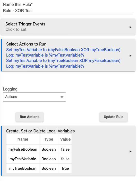

I can reproduce this behavior. My simple test case was this:
This produces the unexpected result:
Where myTestVariable gets set to false in both cases (I tried two in case operand affected the results) where as it should get set to true under the conventional interpretation of XOR, which it looks like @JasonJoel also thinks.

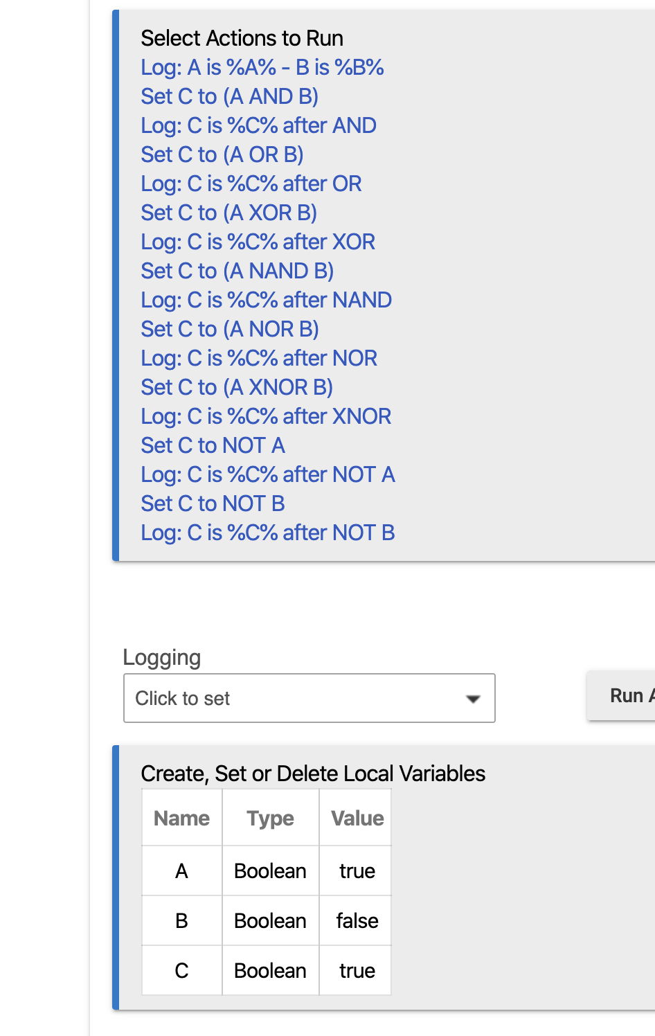

For fun, I tried NAND just in case this was a general problem with the type of action I was using:
This produced the expected result. Then I tried something that I knew should give a false result, like AND. That worked as expected, so then I tried a "weird" operator again, XNOR, that should have also resulted in false. Nope:
@bravenel, I think there might be problems with at least a few of the logical operators in the "Set Variable" feature of RM when used like this (or with at least a few other operators besides XOR):

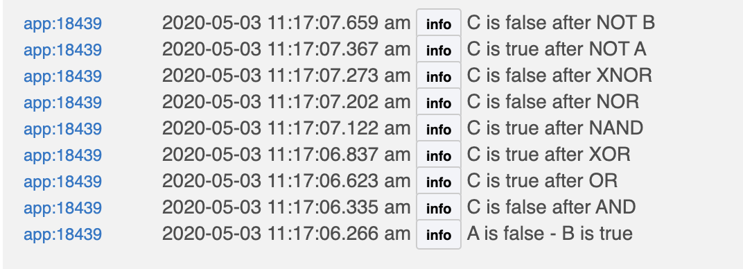

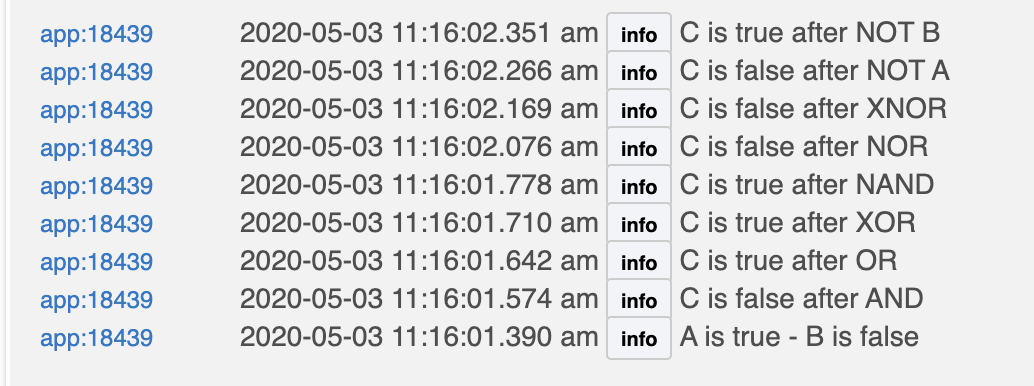

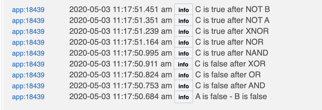

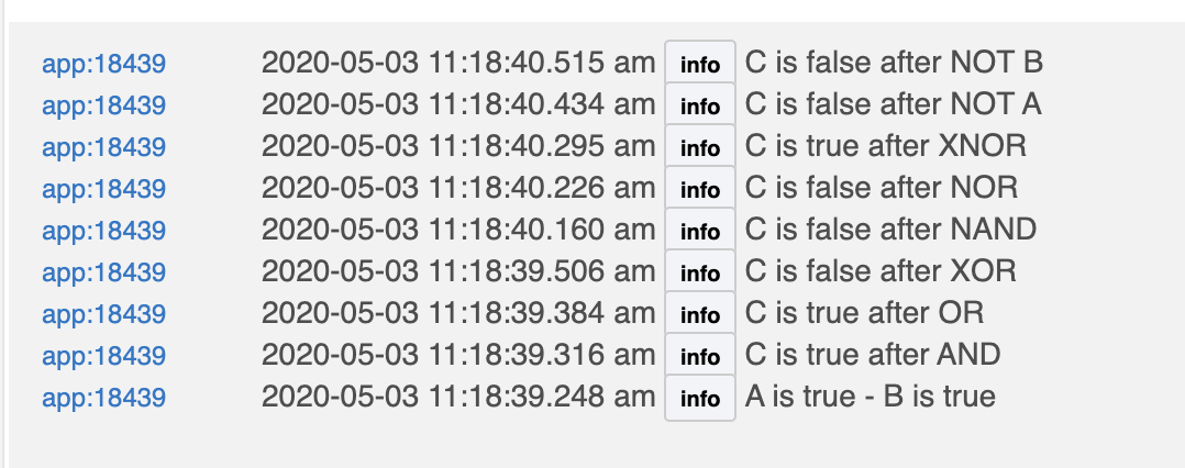

Now four sets of logs for all possible values of true and false for A and B:
