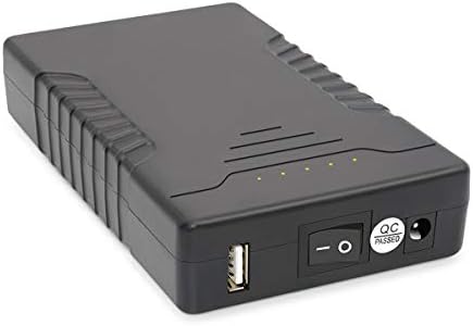

was searching the web and found reference on an arduino forum to this unit that they say is always on and can output and charge at the same time but I have not tried it myself.
raspberrypi forums are using this one
