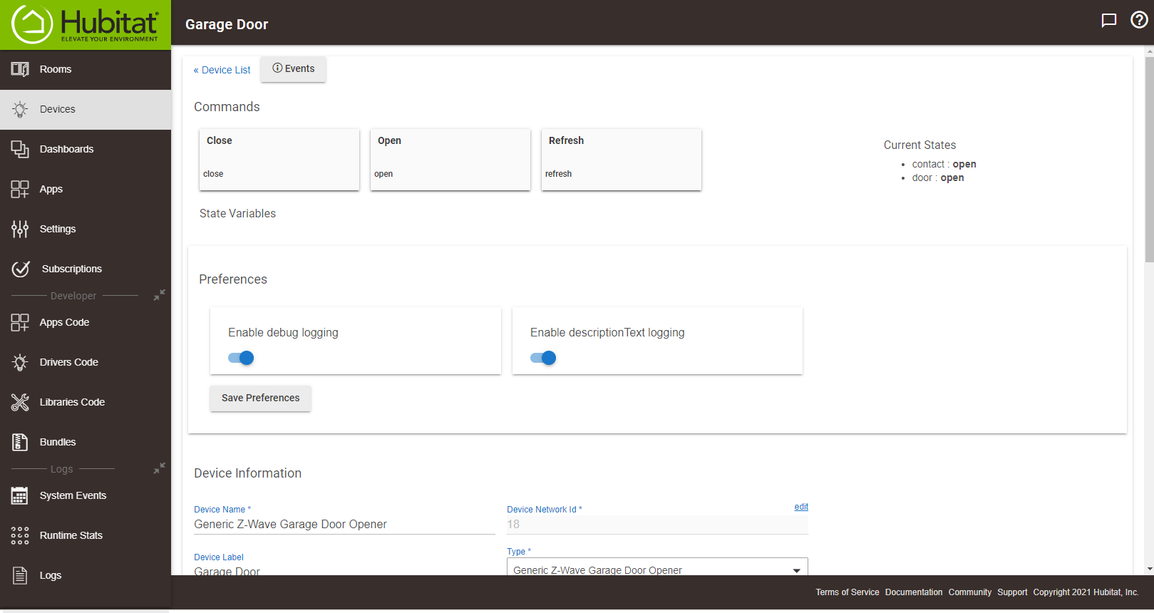

...and we're back to open. The status is showing as open regardless if it is open or closed. I put a new battery in so it's not that. Here are some details...
-garage door is closed (tilt sensor vertical), status shows open, I click refresh, it still shows open
-garage door is closed (tilt sensor vertical), status shows open, I click open, it shows "opening" then status stays open
-garage door is closed (tilt sensor vertical), status shows open, I click close, it shows "closing" while garage door opens, then status stays open (tilt sensor now horizontal)
-garage door is open (tilt sensor horizontal), status shows open, I click close, it shows "closing" while the garage door closes, then status stays open (tilt sensor now vertical).
Everything is working except the proper status.
I'll try anything if anyone has ideas.

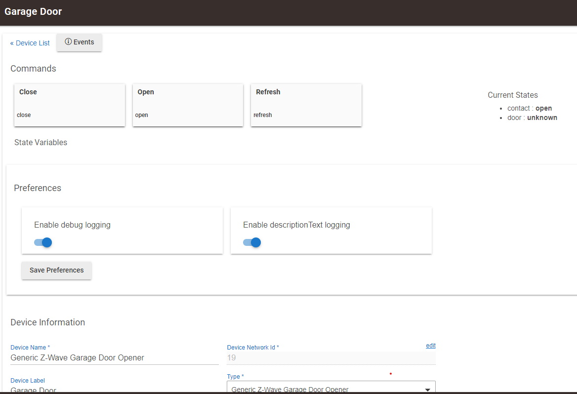

Here is what I mean about no status right away.
This time I didn't exclude and re-include...just unplugged the iris opener as suggested by Sebastian.

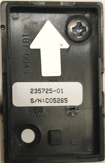

Yea, but that is just the opener if I understand that device correctly. Isn't there an additional tilt sensor on the door somewhere?
correct, there is a tilt sensor that came with it. Here is what i have for the tilt sensor...

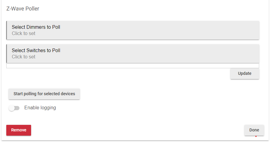

Smartthings polls things in the background, so you probably didn't even notice this before. But on Hubitat, you need to go to Apps, add a built-in app, and choose Zwave Polling.
Feels like you might be onto something. I did try adding it to dashboard, but that was previous to excluding and reincluding...that said, I removed the dashboard.
I went to the "Z-Wave Poller" but there was no way to choose any device, and I don't see where to enable it in the device details.
Hmm, I guess I never tried polling a garage door.
If you hit the "Refresh" button on the device page (second screenshot above), does the status update?
If THAT works, you might be able to do a periodic refresh using a rule.
no matter how many times i click it...no change.

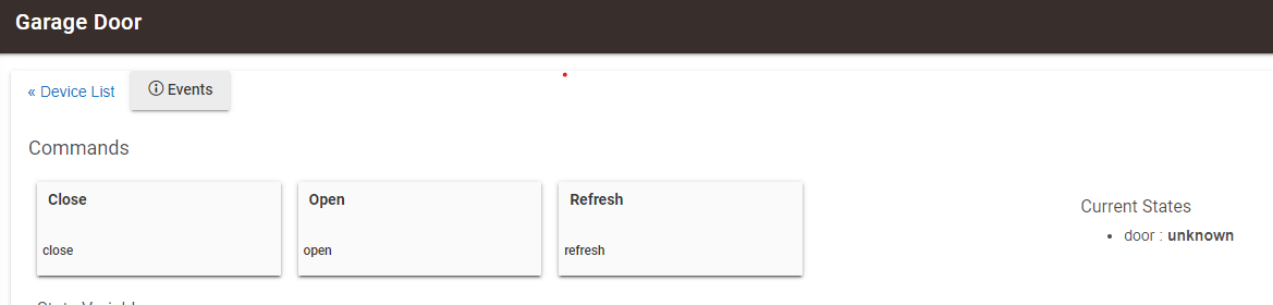

I found this in the list of compatible devices and performed a factory reset as indicated.
it didn't seem to work. Here is what i see now...

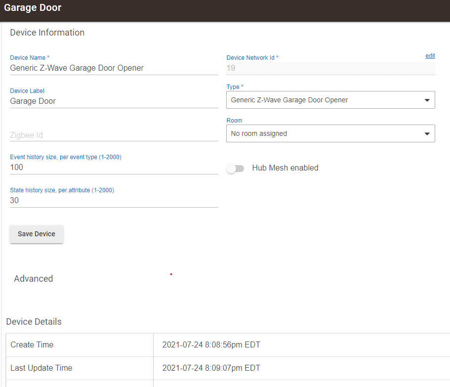

FWIW, based on the inClusters from your screen shot above, you don't have the newer z-wave plus version (model GD-00Z-1). So @neonturbo was spot on.
That makes sense to me, however the model number on my Iris opener is exactly that (GD00Z-1). So if that is the answer, I'm struggling to find how to set it up to be polled.
