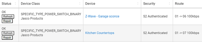

Wow .. this is hard .. Can not remove z-wave device?
I added a z-wave plug without S2 < not sure how. :frowning:
I got the plug so it could do Built-in Repeater Range Extender
The Garage is a little far from the Hub so I thought I could add this to help.
But now I can not z wave exclude it. nor can I remove it manually ?
I want to re-add it as a S2 device. Help ? Platform Version 2.3.6.142
Hardware Version C-8
Not all devices support S2.. And it isn’t a requirement to act as a repeater, even for S2 devices.
If you followed the exclusion instructions for your device and it still won’t exclude, it must be powered off to manually remove.. You will also need to hit refresh until you have the remove option..
