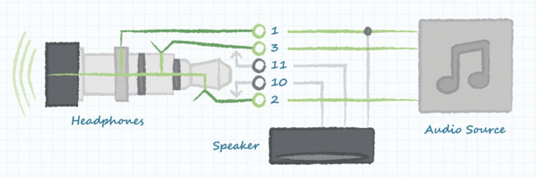

Does it have a headphone jack on the front? Some receivers mute the speakers when headphones are plugged in.
Notice how the circuit from the speakers is redirected to the headphones when the plug is inserted in the jack.
A fingerbot could insert and remove the plug.
Depending on how loud you like it, removing the speakers from the circuit may compromise the output stages of the amplifier.
