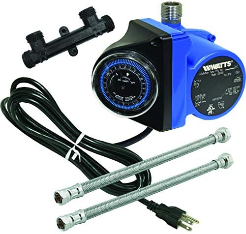

Google the watts recirculation system. Does not require a dedicated return line. It uses the cold line to push water back to the hot water tank.

This is the item that @macdenewf was referring to:
I've had installed two (one for each of my water heaters) since 2014. They're still working just fine.
And for those that might want to know, I spoke with the technical dept at watts. When the pump is on, and valve opened, the pump will provide roughly .25 Gallons per Minute flow so you can calculate roughly how long it takes to flush hot water to your sink. I believe 3/4 inch pipe has about .023 gallons in a foot of pipe snd 1/2 inch has .01.
So. A 50 foot 3/4 inch line only has a little over a gallon If my math is right that means you can can cycle the pump on for just a few minutes at a time and see the benefit. ( providing the valve is also open ).

Yup. Running the pump for 3 minutes is sufficient in my installation. This is kind of important to know because if the pump is left on continuously, and the thermostatic valve fails, the water heater is going to be running pretty much continuously.

I've been reading customer reviews on Amazon on the Watts pump, and ran into a potential issue related to heat traps on the outlet pipes on the top of the water heater that . Results as noted in reviews are mixed...some say the heat traps weren't a big issues, others more concerned.
Any experts care to opine? My water heater (Bradford White M-4-5036FBN) does appear to have the heat trap in place. Sounds like I could remove the heat traps, or have the plumber remove it since he'll be there doing other work.

This issue is the "Heat Trap" in the "Nipple" of the inlet and outlet of the Hot Water Tank. This Heat Trap is to keep the heat in the tank for efficiency. However, with this WATTS pump you are actually circulating the heat out, so defeats the purpose of the Heat Trap. Problem is, to remove the Nipple with Heat Trap from the Hot Water Tank and replace with a normal Nipple is next to impossible. Could not get the Nipples off with a large pipe wrench (even looked on YouTube - risky for damaging Tank). So, I plucked out the little "flaps" that are part of the Heat Trap (see picture) and the pump works better, but still not as advertised. I know removing the flaps likely voids the warranty on my Hot Water Tank, but I wanted the Hot Water! Disappointed.
I can only score a 3 for this pump becuase, 1) WATTS does not state anything about incompatiblity in the specification, and 2) it is not delivering the hot water as advertised in my case, even after taking out the flaps in the Heat Trap. I like the product, easy to install, was really excited about it, but disappointed. I have a couple more days to decide if I will return it. It is better to have pretty warm water rather than very cold water out of faucets for a long time, so maybe keep the pump. We'll see... see lessHeat pump

Recommend the following:
- Remove heat traps from hot water heater before installing pump. Heat traps are typically red and blue plastic inserts with an internal ball or flap that are threaded into the water in and out lines on top of the hot water heater. Heat traps can sometimes throttle or prevent the recirculation flow. Heat traps are not required (actually counter-productive) if a recirculator is used.
- If installation is in a smart home, install the recirculator pump on a smart switch (instead of the included mechanical timer) to enable more flexible scheduling and to eliminate the need to reset timer after power interruptions.
- Clearly mark the four inputs/outputs of the control valve with tape or paint (red arrows for hot, blue for cold, etc.) prior to installation. The control valve is typically installed under sink, which makes reading the small black-on-black labels nearly impossible. The control valve has four inputs/outputs that must be installed correctly. see less

The recirc systems work by bypassing water in the hot line through a valve to your cold line. The water pushed into the cold line ( by nature of the pump on your hot water tank ) ends up flowing back to your hot water tank.
The part that makes this work is the valve under your sink ( or where ever you put it ). That valve is like a thermostatic control. If the water on the hot side vets to cold , the valve opens. If it opens when the pump is on then it recirculates. Once the water reaches a specific temp it shuts again.
So the system needs the valve and the pump to work.
Is the valve is actuated by ācold water ā on the hot side Iām not sure how you could reverse it to actuate with hot water on the cold side.
