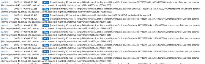

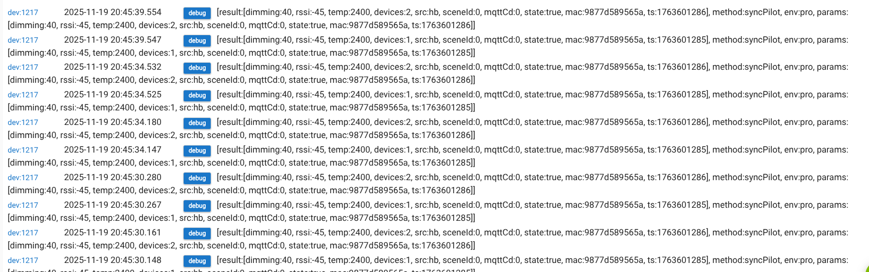

I turned on debug logging for one of the lights and I see they're super chatty... this is a few seconds of debug logs for just one of the bulbs while both LEDs are on:

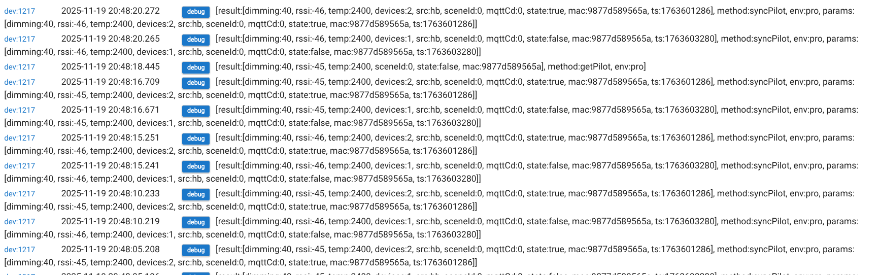

This is a few seconds of the debug log when I turn off the inner LED of that bulb:
As best as I can understand those logs, it looks like the bulbs alternate reporting the state of devices:1 and devices:2. When those are in opposite states, the hub freaks out.

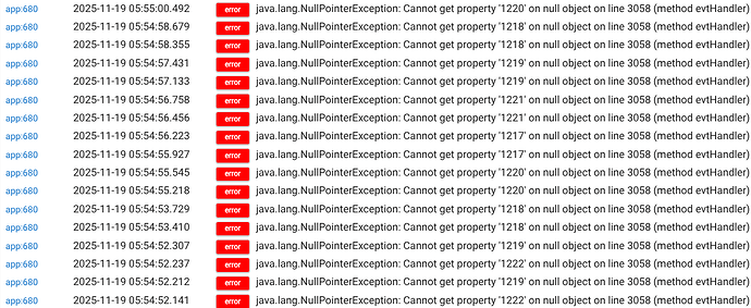

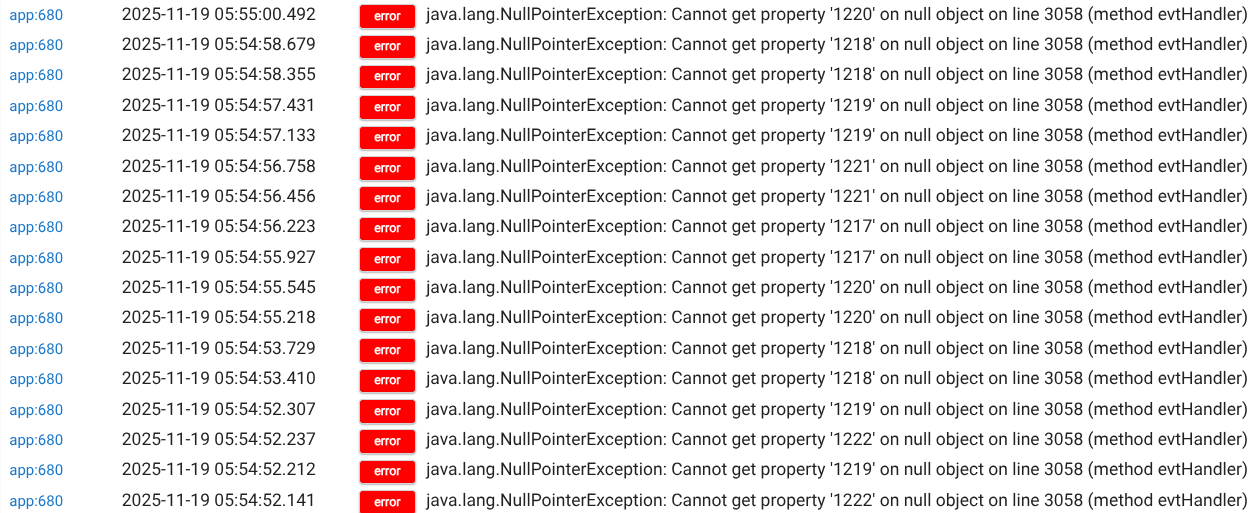

  • The logs were full of null pointer exceptions for a few of the devices. The hub threw these errors from the time the mode switched last night until the mode switched again this morning to one that was not listed as a "means to turn off" in the RL app. The hub logged over 65,000 errors overnight.
  • While lots of other bad things happened in further testing, I did not get these exact errors again.

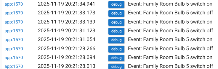

  • I turned on debug logging for the RL app and found it was continuously and rapidly logging on/off commands or events for each of the bulbs.
  • Pausing the RL app got the debug logs to stop flying down the 'live logs' page.
  • I checked the other RL apps that include these bulbs. They all behaved the same if I tried to use my virtual button as a means to turn off and they all had the continuous rapid-fire debug logs.

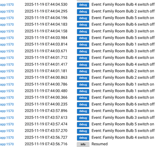

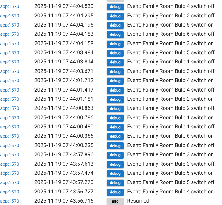

  • I deleted all of the RL apps for these bulbs and created a new one. I just selected the bulbs, turned on debug logging, and clicked "Update" with no other settings changed. The live logs immediately started filling with the on/off commands for the bulbs until I paused the app.
This is what happened when the app was un-paused for about 10 seconds:

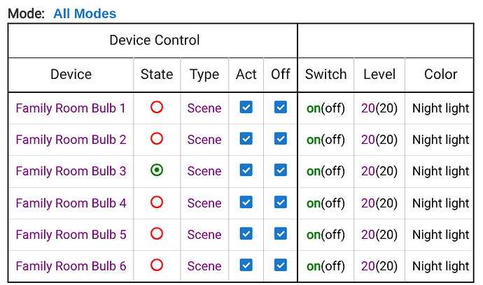

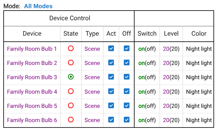

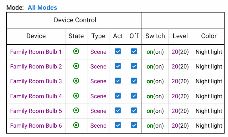

The other strange thing I've noticed is that when I add these bulbs to the room lighting app, the table for configuring them is lighting up like a christmas tree.
Screen recording 2025-11-19 07.51.42
The state icons and the current switch states in the Switch column constantly change between on and off, even when the app is paused. This is consistent with what I see the debug logs showing when the app is un-paused, so I'm wondering if what I'm seeing in the logs is an underlying problem that is just getting exposed by Room Lighting, not an issue with this app.
This was happening while the lights were on. When I turned the lights off, the table stopped updating, but notice that bulb 3 is reported both as on (in the state icon) and off (in the switch column)

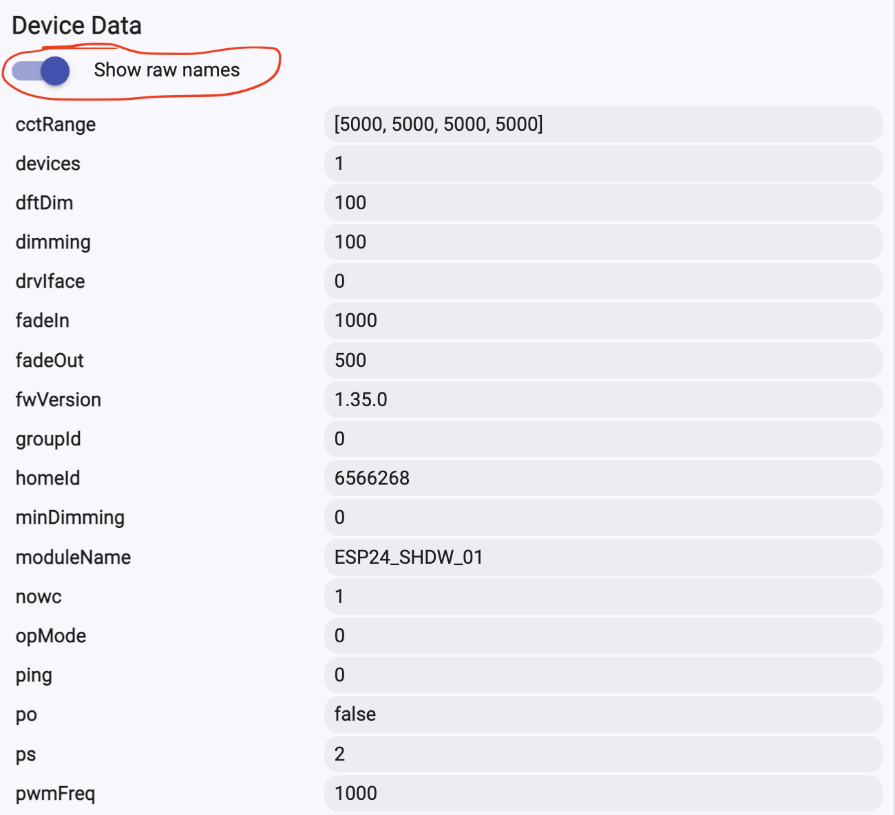

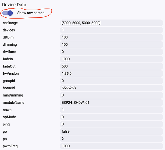

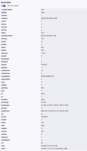

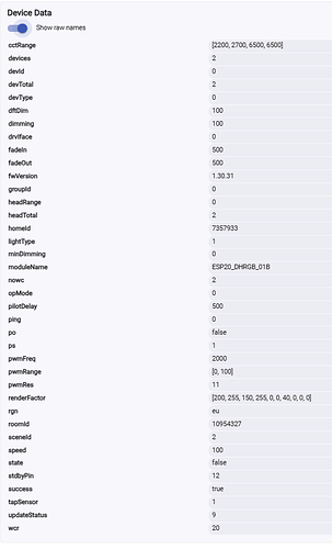

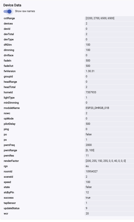

Maybe? Can you post the full Data section from the Device Info tab in raw format? This is the part I'm looking for:
This stuff?
Edit: Hmm, maybe this is better.
IDK :roll_eyes:
Here's one from right after a "Refresh Full" :smiley:
Third time.
