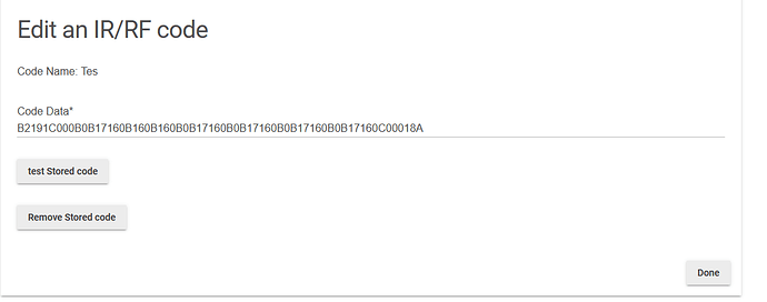

The B219 worked with me
However the codes look a bit odd. I am sure they need to be longer and the second codes kinda looks like it just repeats itself. Copy the below and see if the B219 works when testing. I can't get the second one to work either, but as stated it looks odd, you may want to try capturing it again.

dynamicPage(name: "codeEditPage", title: ""){
section("
Edit an IR/RF code
paragraph "Code Name: ${activeCode.key}"
paragraph ""
input "newCodeData", "textbox", title: "Code Data", required: true, multiple: false, defaultValue: activeCode.value, submitOnChange: false
paragraph ""
input "testStoredCodeBTN", "button", title: "test Stored code"
paragraph ""
input "removeStoredCodeBTN", "button", title: "Remove Stored code"

section("
Selected Device: ${sDeviceDesc}
paragraph ""
paragraph "
Learn failed.
} else if (state.learnResult == "learned") {
unsubscribe()
state.learnStage = null
state.learnResult = null
app.clearSetting("newCodeName")
app.clearSetting("newCodeData")
state.addingCode = true
return dynamicPage(name:"learnCodes", title: oTitle, install: false, uninstall: false){
section("
paragraph ""
paragraph "
Learn Complete.
paragraph ""
input "newCodeName", "text", title: "Code Name", required: true, multiple: false, defaultValue: "", submitOnChange: false
paragraph ""
input "newCodeData", "textbox", title: "Code Data", required: true, multiple: false, defaultValue: state.CODEDATA, submitOnChange: false
paragraph ""
