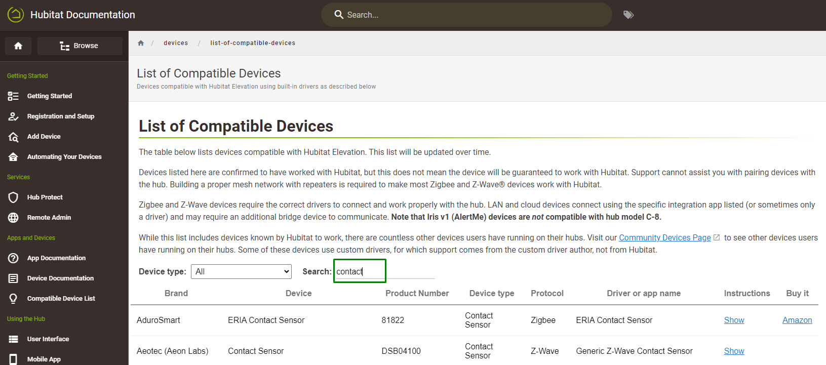

The safest approach is to use devices which are in Hubitat Compatibility list :
