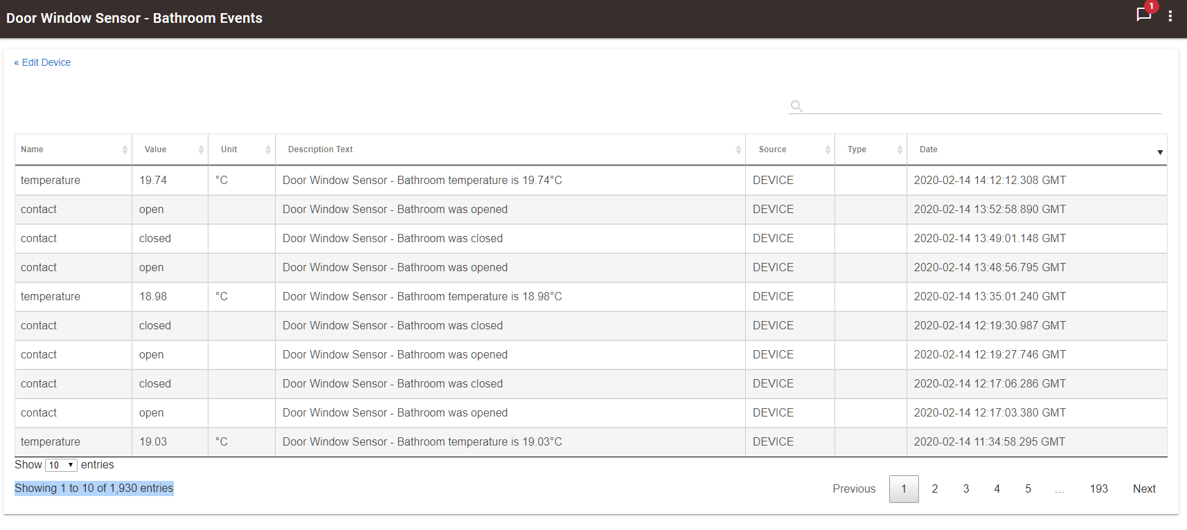

@mike.maxwell could you clarify? Should there be 1000 events per device maximum? Or is it 1000 events per device event type (so 1000 temperature, 1000 contact, 1000 battery).
Would you consider making that something that's settable by the end user?
I certainly don't need to see 100's of pages of events for devices. I'd imagine it's much worse for some devices that log many event types!
Allowing 0 - 1000 with 0 being no event logging and 1000 being the default maximum would suit most users and might help immensely with database corruption, flash wear, possible slow downs, etc?
The quantity of events are kept in history has nothing to do with database corruption or flash wear. A database is damaged by writing (deletion is a write operation).. Write cycles directly impact the longevity of flash.. So it's logical that having the appropriate tools available to limit what is actually written to the database is the better course of action.
That's part of what I suggested .... by setting it to 0 there would be no event logging at all. While anything non-zero (X) allows event logging and prunes to X during whatever maintenance they do overnight as usual.
That seems to be a reasonably quick thing to implement, anything else (different database, per-event-type limits, per-device limits, etc) I would imagine would likely be a bigger job!
