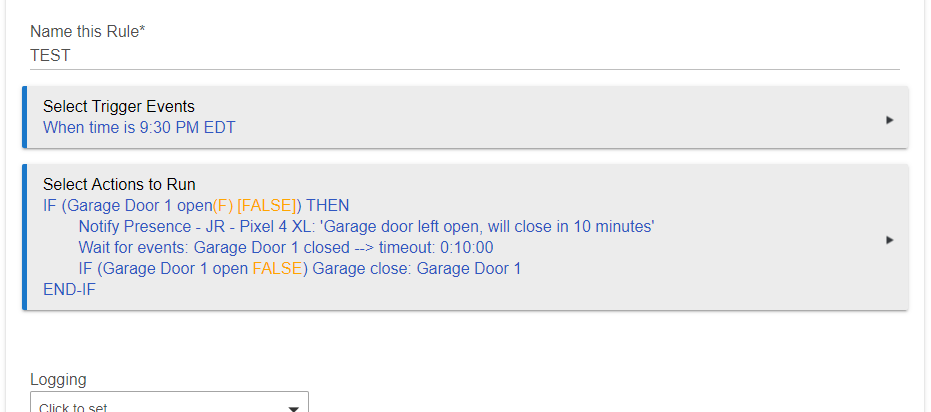

I was commenting on the lack of Time-of-Day trigger. In your case maybe a trigger on Mode change. Need to catch when it was LEFT OPEN, not just when it's opened and it's already late.
Again..it's about usage. 90% of the time my daytime rules are keeping the door closed. If we are working in the driveway and the pause switch is on...then they don't close. First I have indicator lights (a homeseer switch) that on my way to my bedroom are glaringly obviously red. But lets say I'm already in my bed. When I go into "night" mode, the garage door pause vswitch is turned off and the garage doors are checked for being open. If they are open a similar warning that the garage door was left open and HE is closing it is spoken. Then the rule attempts to close the garage door. Last case is someone left something in front of the optical sensor...then the garage door reports back "stopped"* and another announcement is made that the garage door is stopped. That would be then time to get my butt out of bed and see what's going on.
*before someone asks, yes my garage door controller knows how long it takes to shut the door. And if it doesn't report closed after X seconds of the close command,it knows the garage door didn't close completely. Therefor it is in a "stopped" state.
ok, i see how you work now. I'm still newer and do a lot more "control" than "automation".
If you replicate the rule I have above...and add another rule that at 9:30 pm just turns off "garage door pause" it will have your intended action. Aka working in the yard all day (presuming you would have turned on Garage Door Pause so that they wouldn't close after 10 minutes) then at 9:30 it gets turned off and the rule gets triggered. If the door is open it will close after your set number of minutes. You could remove all the "mode" stuff. This would be yours:
and a rule like this:
Now if you ONLY want it to close between two times you could add that like @bravenel showed you in this post:
Or...if I'm gathering correctly what I think you are looking for...that at 9:30 at night if you have not closed your garage door...alert you that it is open and close it for you 10 minutes later if you don't.
In which case....
