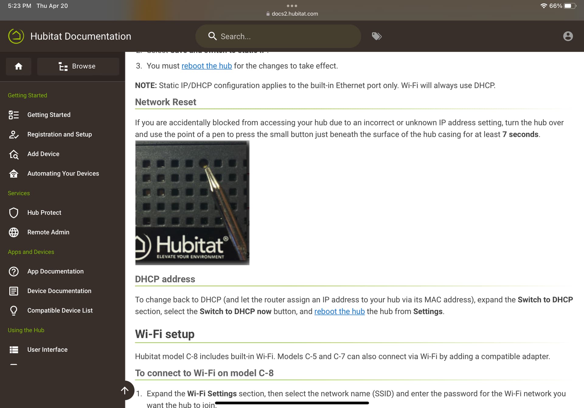

I am facing a lot of issues because of this. I want to use the LAN for all processing, is there a way to remove or uninstall the wifi drivers? or any other way to fix this connection issue?
Please suggest
Press and hold the network reset button on the bottom of the hub for at least 7 seconds. The hub will then reboot itself and the networking should be back to Ethernet with DHCP.
Is that reset with the hub powered or off?
With the hub powered on.
Thanks - the reboot was what reset for me. Without that, I had both LAN and WiFi active at 2 different IP's.
