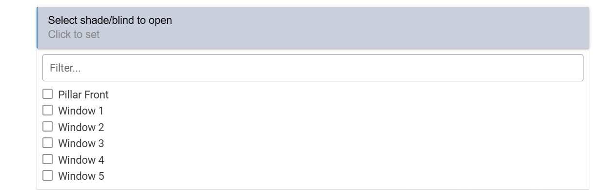

Why would a dimmer show up as a blind?
I'm hoping pictures tells a 1000 words...just have no idea why I'm see this.

Maybe just a couple of words describing what is wrong would help here. I assume that the Pillar Front is not a blind?

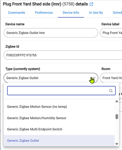

Once you browse to the device’s settings page in the hub interface, you can see which driver is in use.
There’s no way to understand what’s wrong without doing that.
No reason to do this until you’ve clarified which driver was auto-assigned to the device when it was paired.
Why do this if you know what the other devices are? Just make the odd device match the driver from the good ones.
You shouldn't have to do anything more than that.
All you need to do is go to the Device page for the plug, go to the Device Info tab, and then change the driver via the drop down to the same driver your other plugs are using. Takes like a couple seconds.
After changing the driver go to the Commands tab for the device and hit the Configure option. Done.

Pretty much impossible that they are all on the same driver if they aren't all showing up as the same device type. Driver determines exposed device type AFAIK. Have you gone to the device page for that plug and looked at the current driver setting, compared it to the other devices?
Which specific one?
Check the one that is showing up as a shade.

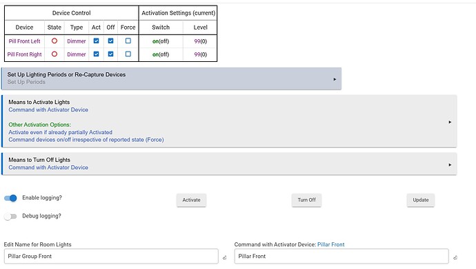

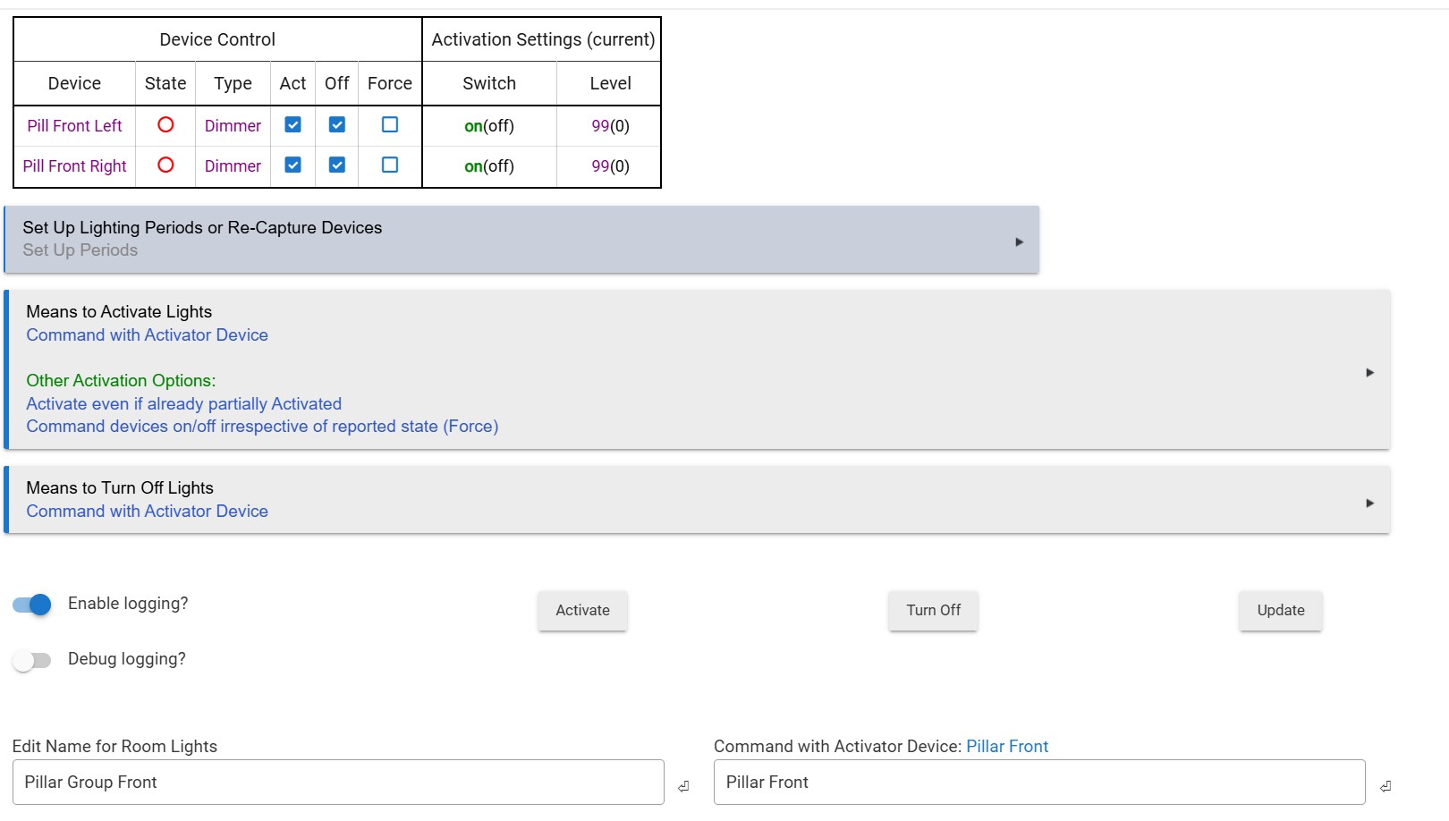

I went back to work on this ...this morning. You probably noticed in the screenshot above that the device is a room lighting app activator device. I was thinking the issue was with the physical. My bad.
I simply created a new identical one and deleted the one that came up listed with the blinds. All I see now in my blinds list are my blinds now.
