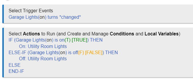

Why isn't this rule shutting off my light?
Lights go on with no problem, but the off event never triggers.
2022-12-27 15_46_09-CONV-Garage Lights
You have an extra "Else" at the end of the rule - try removing that.
Gonna try removing it, but I always have a blank else in all my statements.
Hopefully it works - nothing else jumps out at me as a possible issue. If still not working, maybe try:
If garage on
  Utility on
End-if
If garage off
  Utility off
End-if
There's no reason to do that.
I know it doesn't add anything, just a throwback to some coding I used to do, the blank else shouldn't hurt anything.
Just tested, no change. I think I may need to add a poll statement. The "Garage Light" isn't updating it's state when I turn it off. It's a Jasco/GE ZWave light switch.
Ah, yep, if it's an older GE/Jasco (non ZW-Plus), then it'll need a poll for update.
If you want to simplify the rule (after you enabled z-wave polling), you could do this. The end result will be the same:
Trigger: Garage turns on
Actions:
Turn on Utility
Wait for Event Garage turns off
Turn off Utility
or this
trigger garage light turns change
if garage light on
on utility room light
else
off utility room light
end if
Or use the Mirror app.
