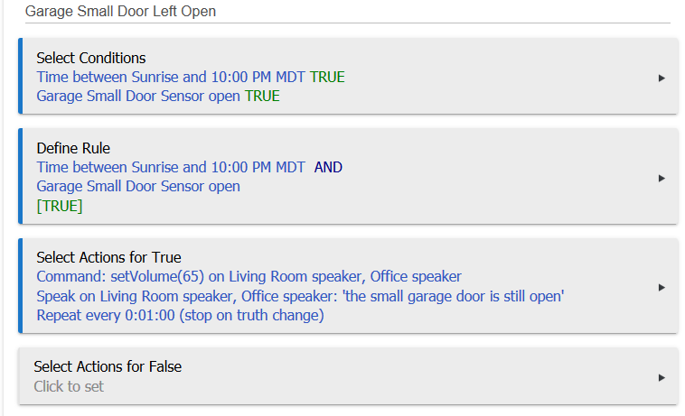

I have the following rule that I thought was straight forward but it does not want to repeat if the door is left open. Any help appreciated. Time reduced for testing.
Order matters. Get that Repeat action up to the top.

Post screenshot. Assuming the rule is still TRUE I’d expect it to keep repeating
@liquidskin My bad... I had the dang rule open... it works fine now.
