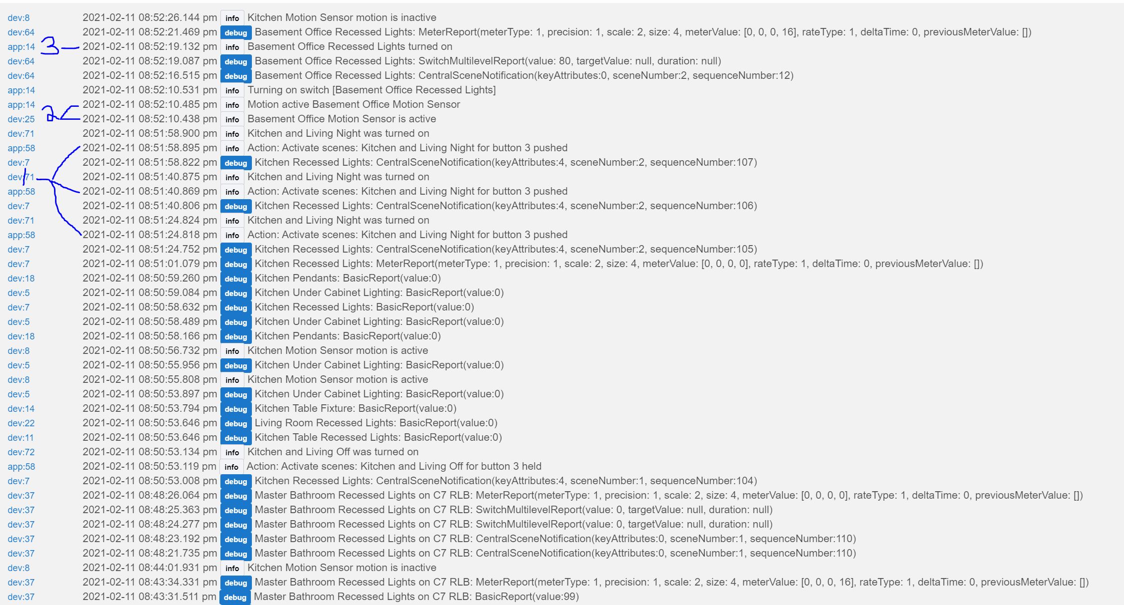

I've gotten this to about 90% satisfaction, by purchasing a second hub and using mesh. This issue used to be much worse. Tonight I have a good example with logs and I'm hoping someone can see something to help understand why the hub fails to respond.
Starting with 1, I'm trying to activate a scene that turns on a lamp and under cabinet lighting. I try 3 times with 15 second intervals and give up.
2, I walk downstairs and trigger my basement office motion which should turn on the lights. The motion is detected in logs but the lights don't come on.
  1. I give up and turn the lights on the old fashion way, lol.
Is this to be expected from time to time? If not how do I go about pinning down the issue?

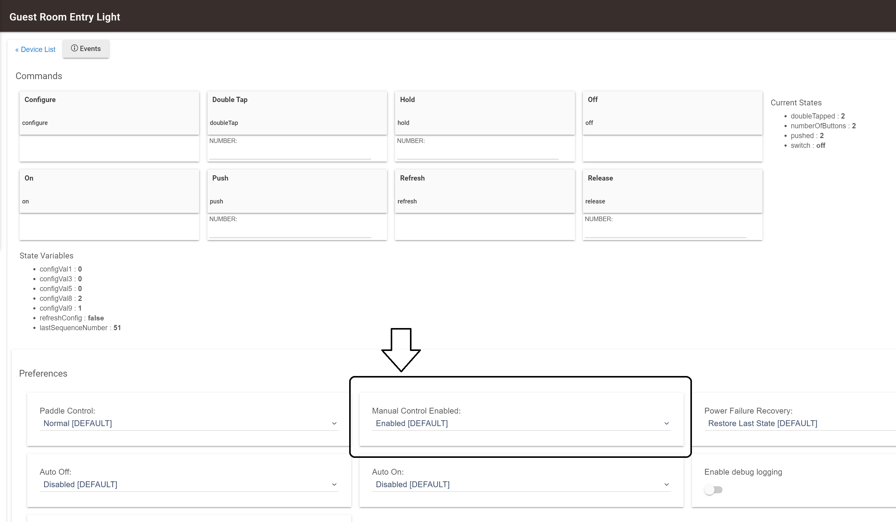

No sorry wasn't clear - "disabling" the load control on the dimmer. I know you can do this with newer Zooz models but not sure about Inovelli.
This is feature is what I was thinking:
The other thing you can do is decouple the load from the dimmer and use rules to control. I've done this with switches but dimmers seem a bit more challenging.
ok yes understood now. Last night I switched the bulbs to virtual control, I wish there was a better way to do this. Right now its kind of clunky. I'll see if this helps with the original zwave issue.
