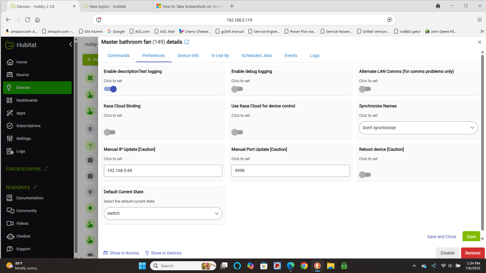

What you likely mean is that you moved your Kasa devices from using a cloud-dependent integration with Hubitat to using a fully-local integration.
Either way, these devices are always connected via WiFi.
FWIW, I’m pretty sure that @zbernie123’s Kasa devices are connected locally.
Turn off Cloud binding and Use Kasa Cloud for device control on the preferences page.
Yes, locally.
Thanks! We will see tonight at 11:30 PM!
My stupid mistake -- The porch light switch is one of the few Z-Wave devices that came with the house. I have Kasa on the brain!
