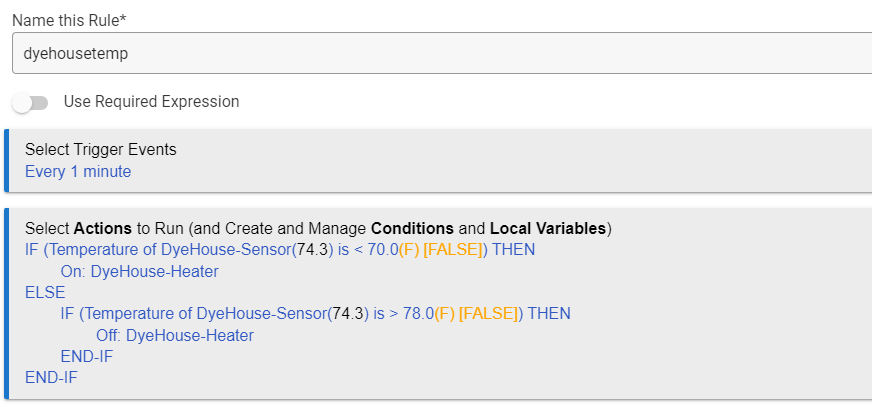

This rule turns on/off a heater (via a z-wave switch) based on temperature.
This one DOES NOT work:

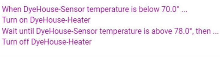

This one works:

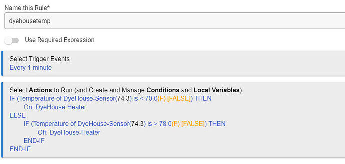

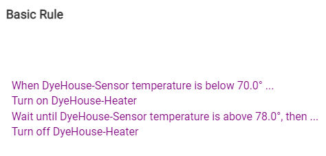

This one works:

Yours:
Mine:

I think I found the problem. The "temperature change in degrees" in the driver overrides the "Report Interval" setting. So if the temperature did not change enough the report interval is ignored.
The Basic Rule is a simpler approach, rather than running the Rule Machine rule every minute which will be going off even when there is no temp change.
You could change the RM rule to run when there is a reported temperature change from the sensor, so it only needs to be active when something significant is happening.
Or change the RM rule trigger to have two triggers, (if temp < 70 or if temp >78) and you can use the same if statement in the rule body.
