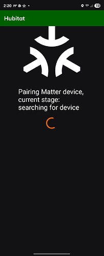

Some times it can't find the device. Sometimes it goes through the first phasev then crashes out in the second phase.

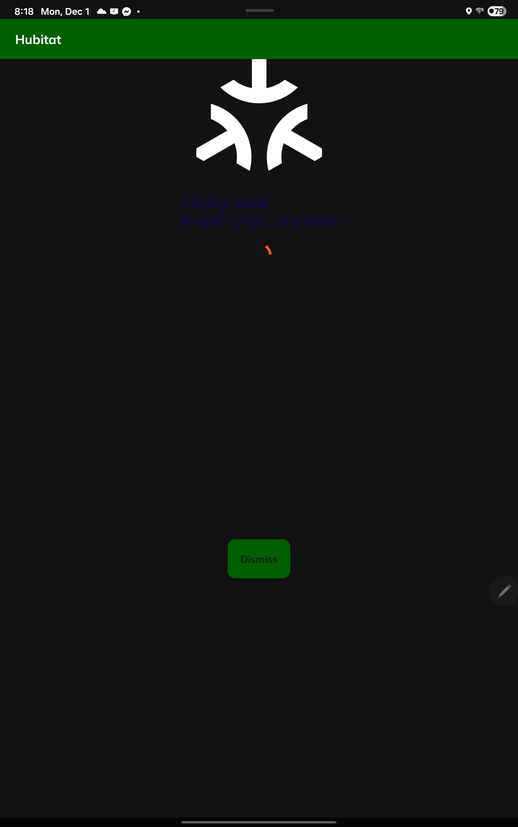

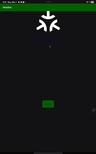

Little more luck tonight. I was able pair 1. Then on the second one i kept getting this error
Then i could pair another one. Then i got this error
So i could pair 1, then had to reboot between pairings.
