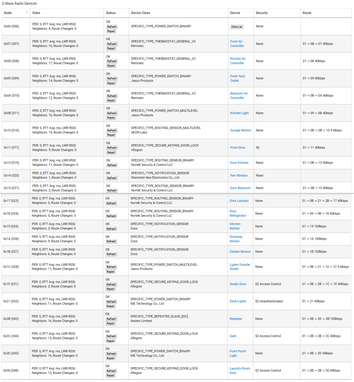

Here's the device list in CSV format.
"SPECIFIC_TYPE_THERMOSTAT_GENERAL_V2
Remotec ",,Front Air Controller ,,,,None,,,,01 -> 0B -> 07 40kbps

Very hard to read that. A screen shot would be easier.
Sorry, I didn't expect you to read it like that; rather paste it to a csv file and open that as a spreadsheet.
Here's a screen image.

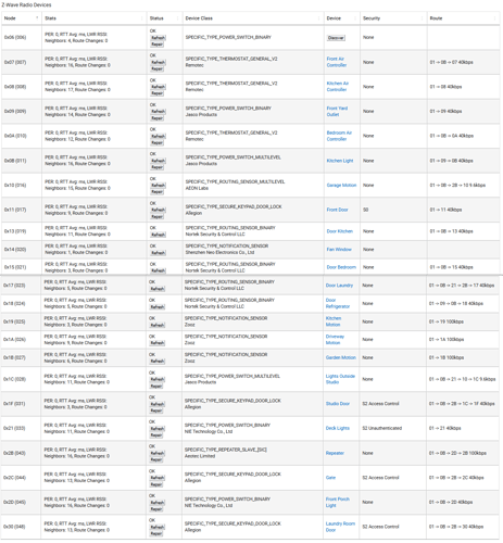

0x06 is a ghost and must be removed.
[Discover],[Refresh] and [Repair] all fail to provide a [Remove] option. Will keep trying...
Six attempts later, and the ghost is finally vanquished.

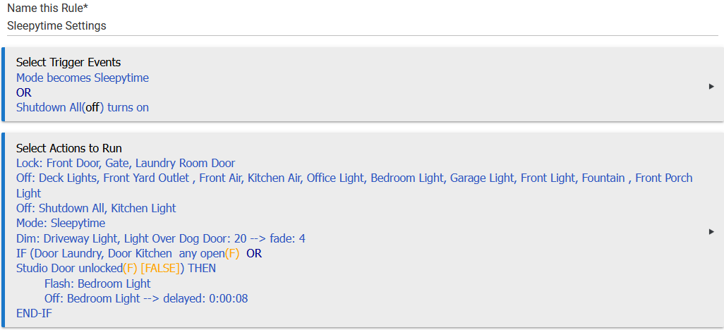

in your rule, are you turning off all 6 devices in the rule? might be helpful to create a group containing those 6 devices (that turns on if any are on), then turn off the group in your rule
One of the rule's actions is "Switch Off", under which I can check the boxes for each of the devices I want turned off. Not sure if that answers your question.
Can you post a screenshot of your rule?
it does. you're turning off all 6 one at a time
Mesh issues aside, isn't this why the "meter" option was added a while back? So that you could spread out commands and not blast them out all at once?

There's more than 1 rule which exhibits the issue. Here's one:
And here's another:
I suggest doing what @dylan.c (sorry, @dadarkgtprince) suggested:
  1. Using the groups and scenes app create a group that contains the switches you want to control.
  2. When you create the group, enable metering with a delay of 200 ms.
  3. Try controlling the group device from its device page - if it works reliably with metering of 200 ms, then try reducing it to 150 ms or 175 ms. Use the lowest metering value that is reproducibly reliable with the group device.
  4. Use the group device in your Rule.
