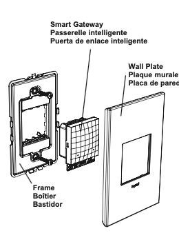

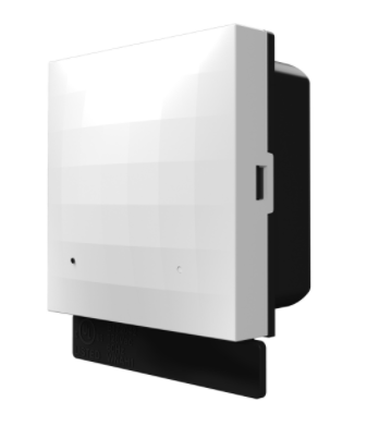

I was looking at Legrand and noticed they are offering a set of WiFi switches, dimmers and outlets BUT they also have a set of "Smart" devices, without making it clear what the difference is.
Then I found their Smart Gateway. It's a WiFi to Zigbee hub, that is 2"x2" and fits in a wall box:
Screen Shot 2021-10-07 at 10.49.12 AM
Screen Shot 2021-10-07 at 10.59.16 AM
Just provide AC power, use their app to connect it to your WiFi and then join in all your Legrand Smart devices... that's the marketing take on it apparently :slight_smile:
There's no particular FCC data on this particular model but there is for the other form factor:
It may be that other vendors are obscuring their "Smart" technology and glossing over their Zigbee roots.

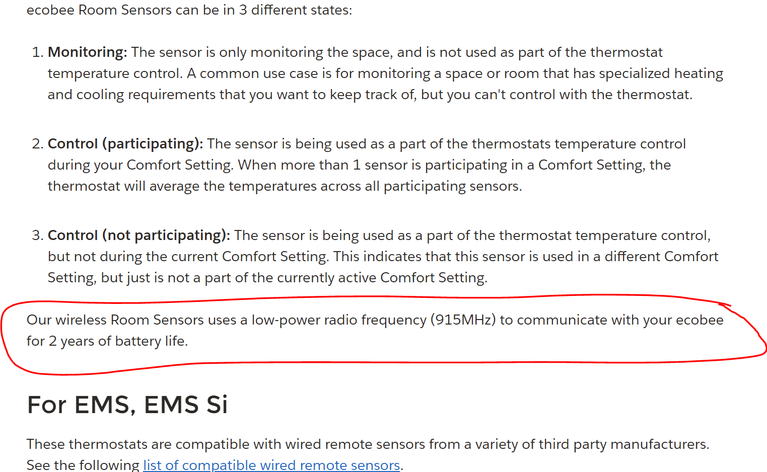

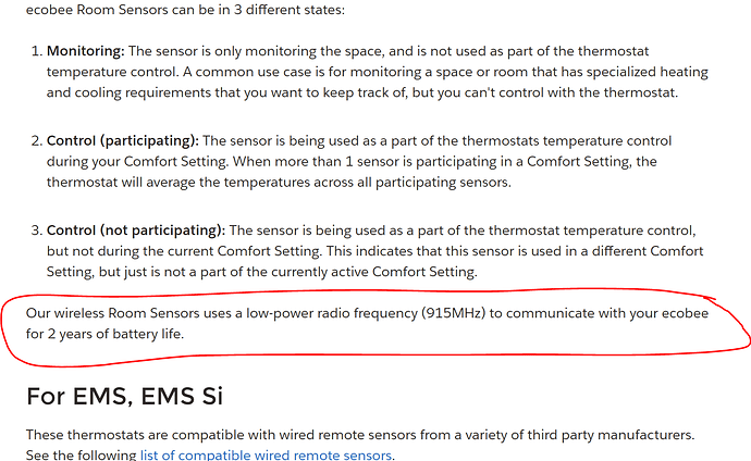

ecobee does that for sure. Their thermostats have a zigbee radio that uses zigbee channels 6-10, which is used to communicate with their remote "smart" sensors.
Are you referring to their thermostat remote temperature/occupancy sensors? Or something different?
Looks like the Ecobee thermostat remote sensors actually use 915MHz, according to their web site.
Help Centre.
Correct.
I was told a long time ago that the sensors used anywhere from 915-924 MHz, which covers zigbee channels 5-10 (I incorrectly wrote 6-10 above).
Edit: also this link is helpful, and suggests that it is actually zigbee channels 1-10.
https://fccid.io/WR9EBSTATZBE3
