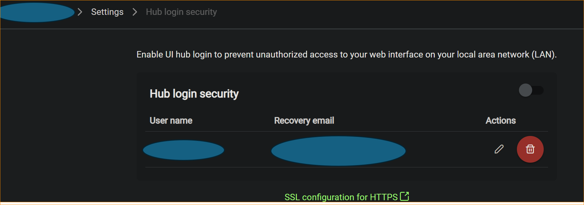

I was very happy to see an option to define a username/password to log into my HE.
When I selected that option, I got the following page.
I created my own username/password and saved it off.
When I log into my HE using the Mobile App, I have to go through the login process with my recovery email and my account password.
When I am sitting here at my laptop on a hardwire connection to my HE and using Chrome to access the HE, I have NEVER been prompted to enter the username that I created!

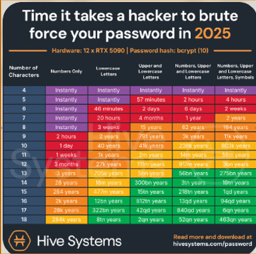

Seriously consider the vulnerability of your passwords in 2025 knowing the following information.
With the explosion of AI, especially within the mathematics world, I fully expect that this chart will be significantly changed in the very near future that could make 18 character complex passwords crackable in a very short period of time.
Keep in mind that the chart is brute force. When an attack is using massive AI tokens and working the math out, it would take a bit of information about the encryption seeds to figure everything out. Or some lucky guesses.

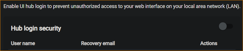

Paul, did you happen to review the help page to ensure you completed the needed steps?
Hub Login Security (Settings) | Hubitat Documentation?
The toggle switch in the upper right of the screenshot is toggled to โ€œoff.โ€
Toggling it on should enable hub login security.

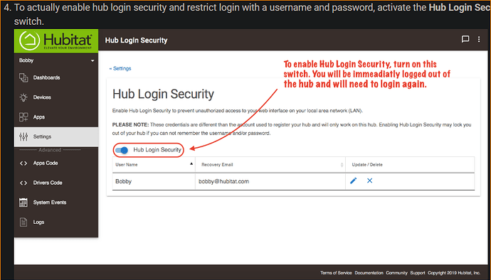

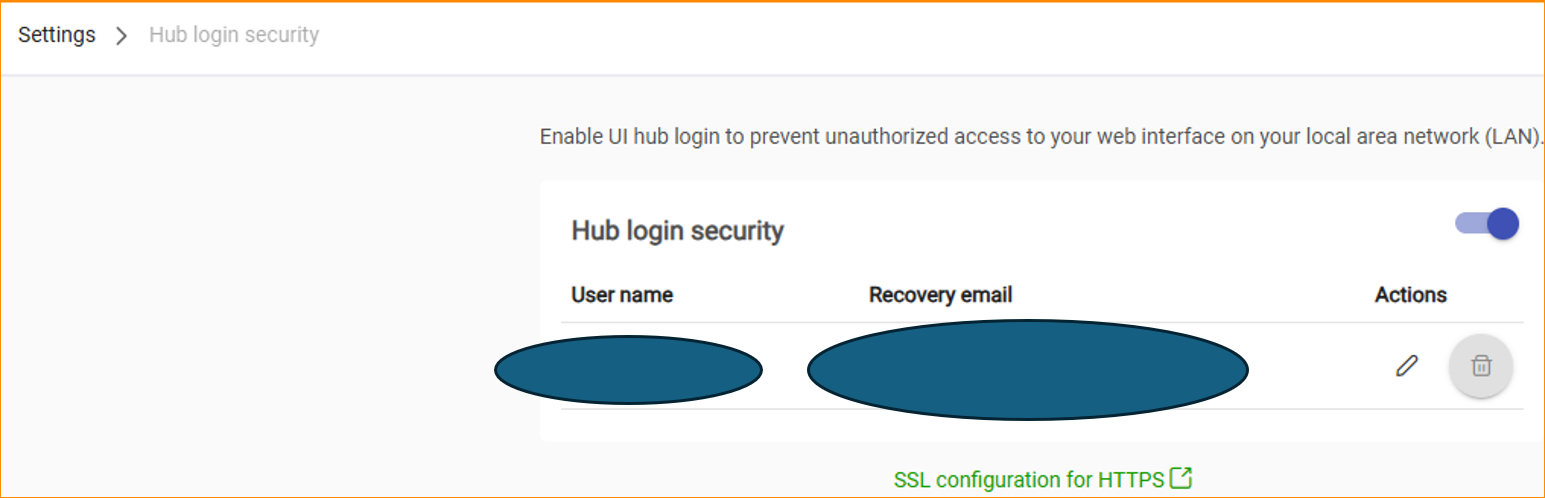

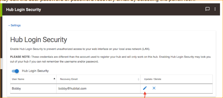

The following is the documentation page.

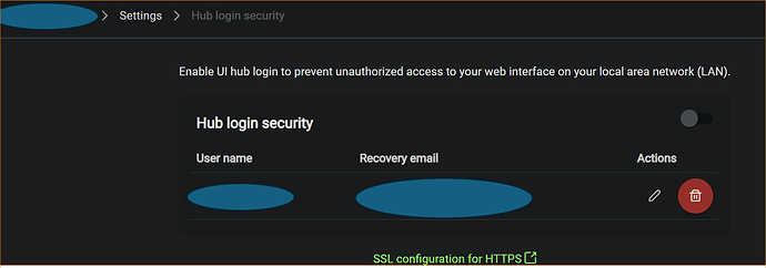

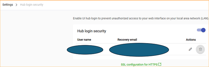

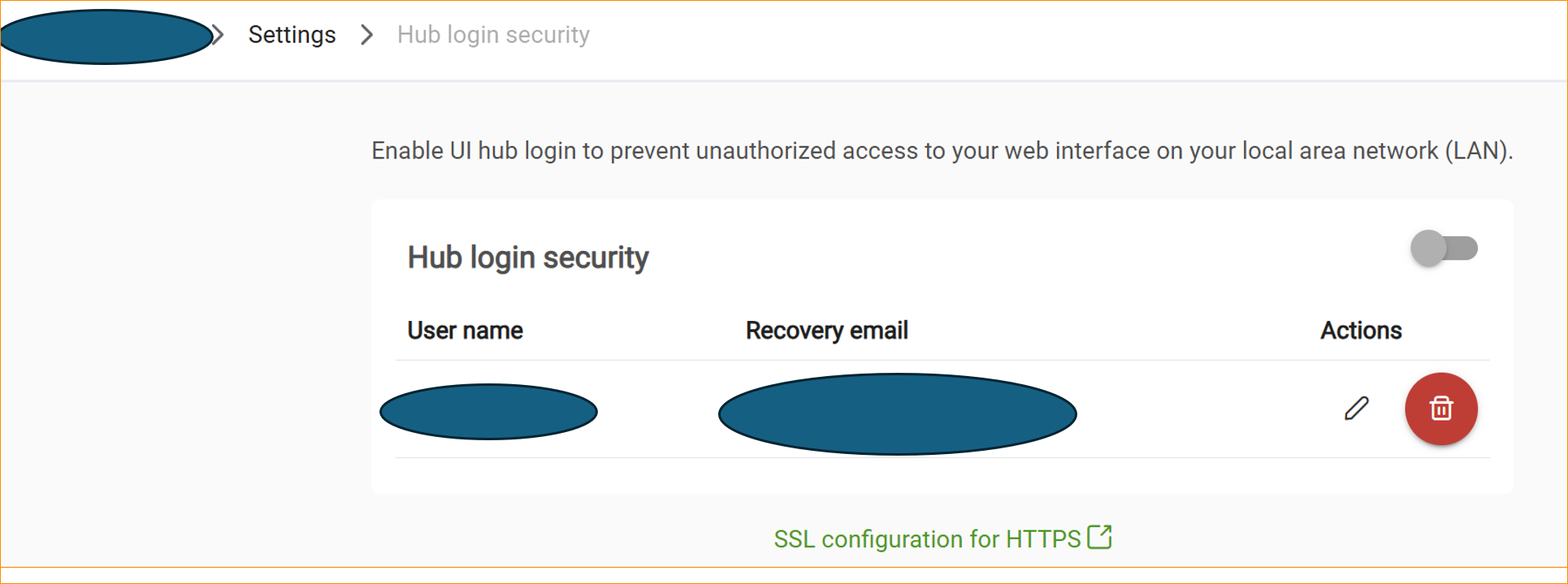

The following is what I saw with the Chrome browser in dark mode, which helps with my eyesight problems and what I normally run in.
The page naturally looks like the following.
I should have guessed that the toggle button was there for a reason and just clicked it.
It would have been better to have the web page that shows up when running HE 2.4.3.133 show up like the page in the documentation.

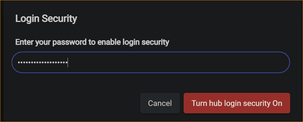

One other documentation discrepency is that once I flipped the toggle switch to enable the login security, I get the following window showing up.
I was not logged out of the hub when I clicked on 'Turn hub login security On' AND the window that I was on at the time remained open.
I did get a new browser window opened up that is asking for my login credentials.
So now I have two windows. The original Settings window that I used to enable security and the login window.
I was able to click other things such as Apps and Devices in the original window.
Basically I could ignore the login window at this point and do whatever.

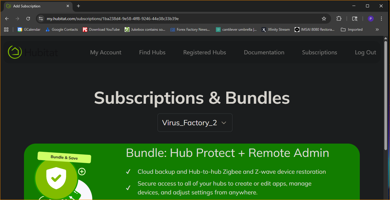

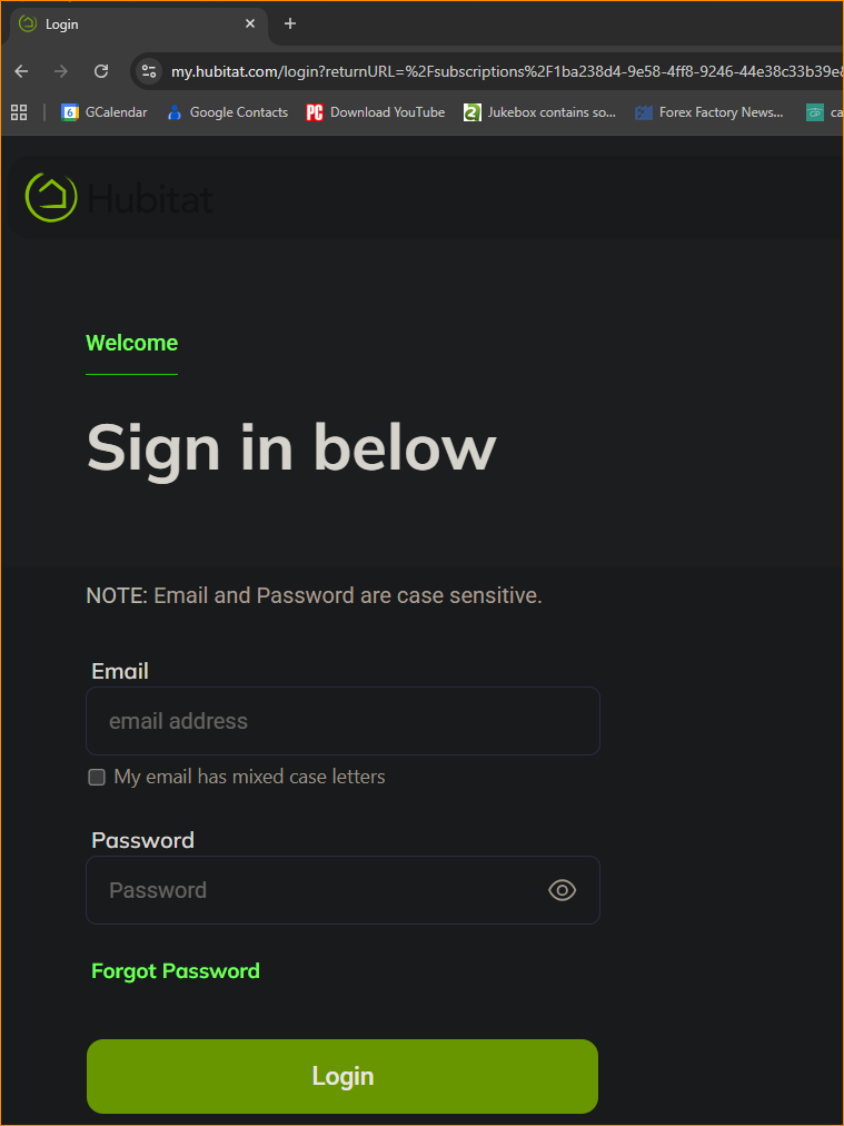

That new 'login window' is to the cloud account, NOT the HE hub on my local network!
Logging into that web page got me to:
I logged out of that window and closed it. All of this was done in Chrome to this point.

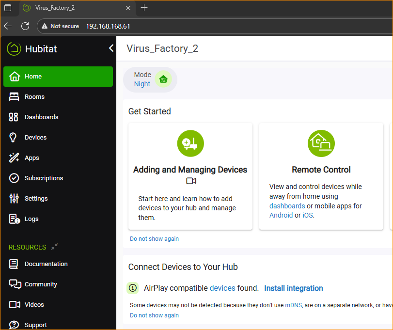

My 'Home' window in the MS Edge browser shows the following.

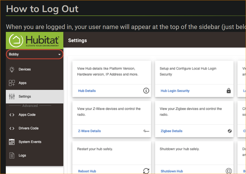

The major item to note is that the page is missing my username under the Hubitat logo in the upper left corner, as the documentation states should be there.
I have no equivalent of the 'Bobby' entry mentioned in the documentation on my window!
Which means I have no means to do a clean logout of the HE on my Microsoft Edge browser page!

The only step I missed was moving the toggle to enable it. It was a toggle out on the right edge with nothing around it. And that web page does NOT currently match the documentation.

The documentation says that once I enable the Secure Login toggle I will immediately logged out of the hub and will need to log in again.
I fully expected that to happen.
What ACTUALLY happened is that a new tab was opened up in my browser asking for login creds. I thought that was great, and that the new tab would be to the login page of the HE DEVICE. Nope. The login page was to the Cloud account! WHY the cloud account when the documentation said I would need to log into the HE device?
AND the original browser tab was left open, right where it was originally and I could move around to any web page within the HE!
My expectation was that when I flipped the Security toggle, the HE would log me out of the existing admin web page which would leave me at either a login page or a web page that said something like "You have been logged out the HE device, please click 'here' to redirect to the login page". Where 'here' is a hyperlink to the HE device URL for logging into the device.

I also found an interesting icon on the HE web pages now, that provides for LOGGING OUT of the HE! The documentation says it should be available above the HOME entry in the left column where the account name SHOULD be displayed, but isn't.
What I found is the following button in the upper right hand corner of the web page for logging out of the HE!
Which is another item not mentioned in the documentation.
Paul
The user interface received a significant overhall recently in platform 2.4.0, and each version since has continued evolving several pages. Occasionally, you will see the old interface in screenshots/docs that have not yet been touched (or slipped through the cracks). When this happens, you can usually find the same thing, just looking slightly different.
And that's what's happening here:
The logout option has moved to this location -- it's not "another item" but rather the same feature.
This docs will likely be updated soon, however. Glad you figured it out!
