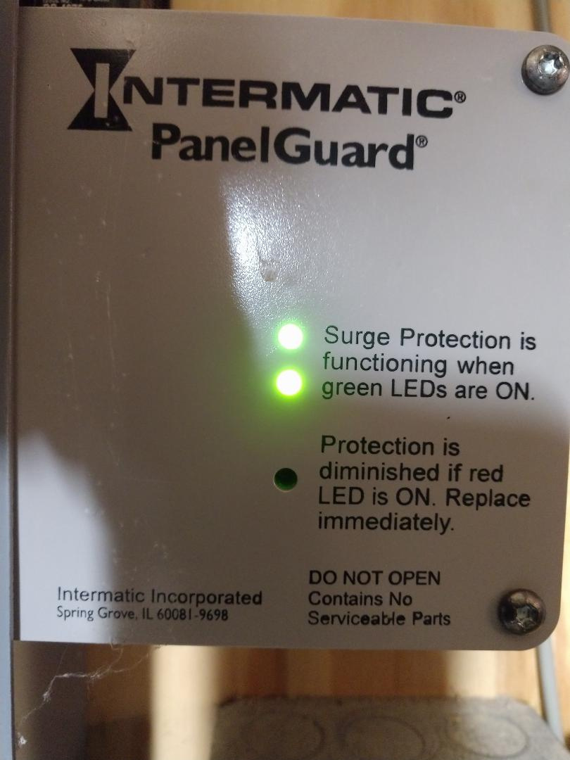

Got my Intermatic installed. Got lucky, I was able to shift the breakers down and only had to rewire one breaker to fit the dual pole breaker in for the Intermatic.
The only real issue, is that the LEDs are all but invisible when I'm in the utility room, as I have motion lighting in there, so as soon as someone enters the room, the lights come on. Part of the problem, is that the holes Intermatic left in the front of the panel are very small. I think Enlarging them would help, or possibly putting a light pipe/lense in the holes...in the meantime, I'll just have to shut out the lights on occasion and check the panel.
