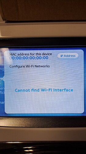

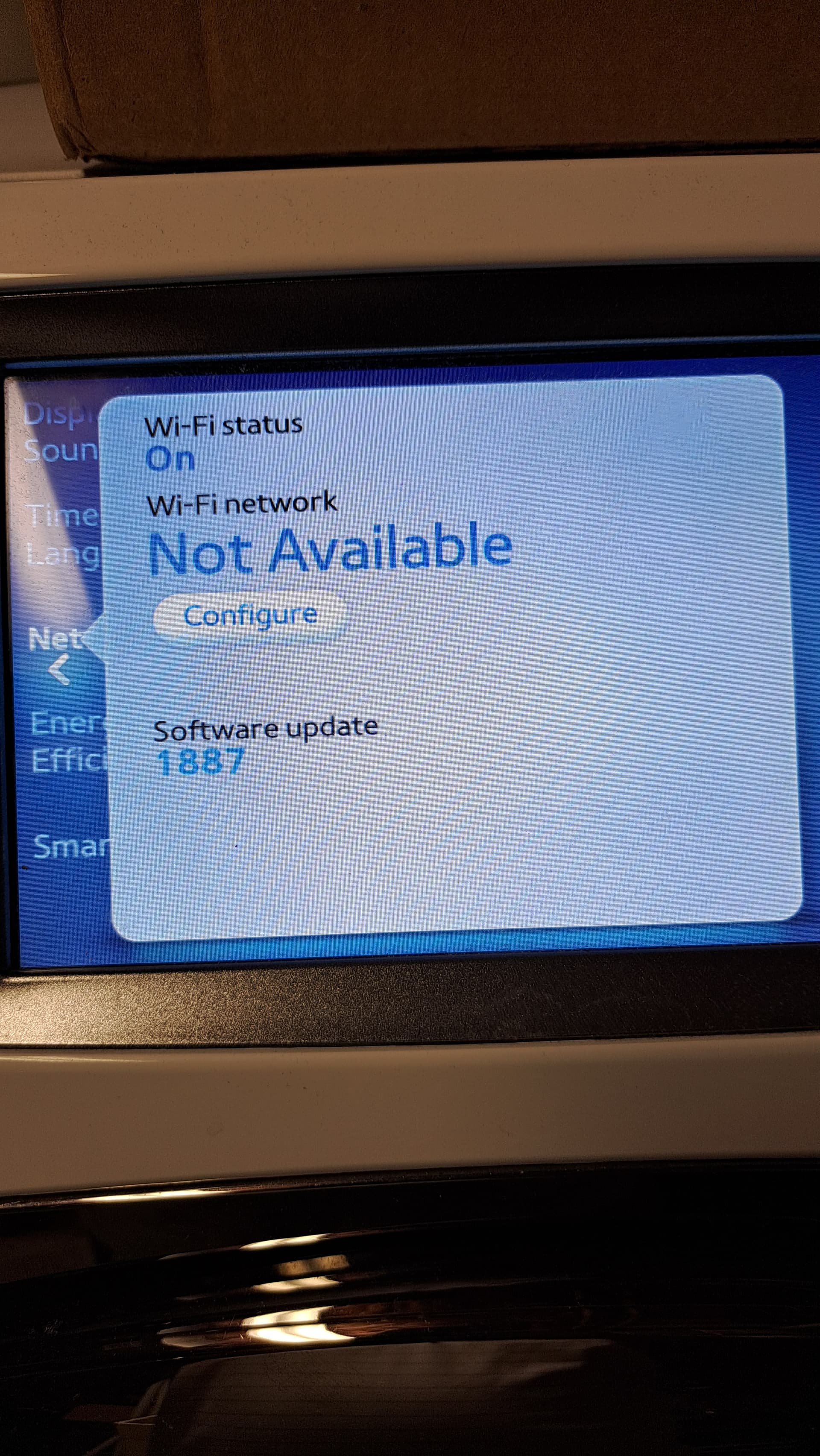

The house I moved into a few months ago has a smart Samsung washer/dryer. My phone sees the password-protected Samsung Wi-Fi network broadcasted. However if I go to the dryer settings, it says there's no wireless interface but wifi status is on. Any suggestions?
EDIT: I tried adding thru SmartThings app but the model# is not listed as option. App says to add using a barcode or pushing smart button and my dryer has neither.
My model is a DV457EVGSWR/A1.
I don't have an answer for you but that MAC address is invalid. This should be a unique value assigned by the manufacturer that is physically embedded in the device.
It is possible in many modern devices to override the built-in MAC address with a software assigned value so perhaps there is some bug in the firmware that is causing is to be software assigned that invalid 00:00:00:00:00:00 value.
If it remains in that state and you see no firmware options to modify the MAC address I would contact Samsung.
