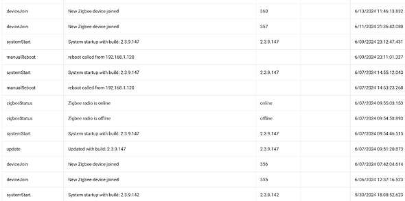

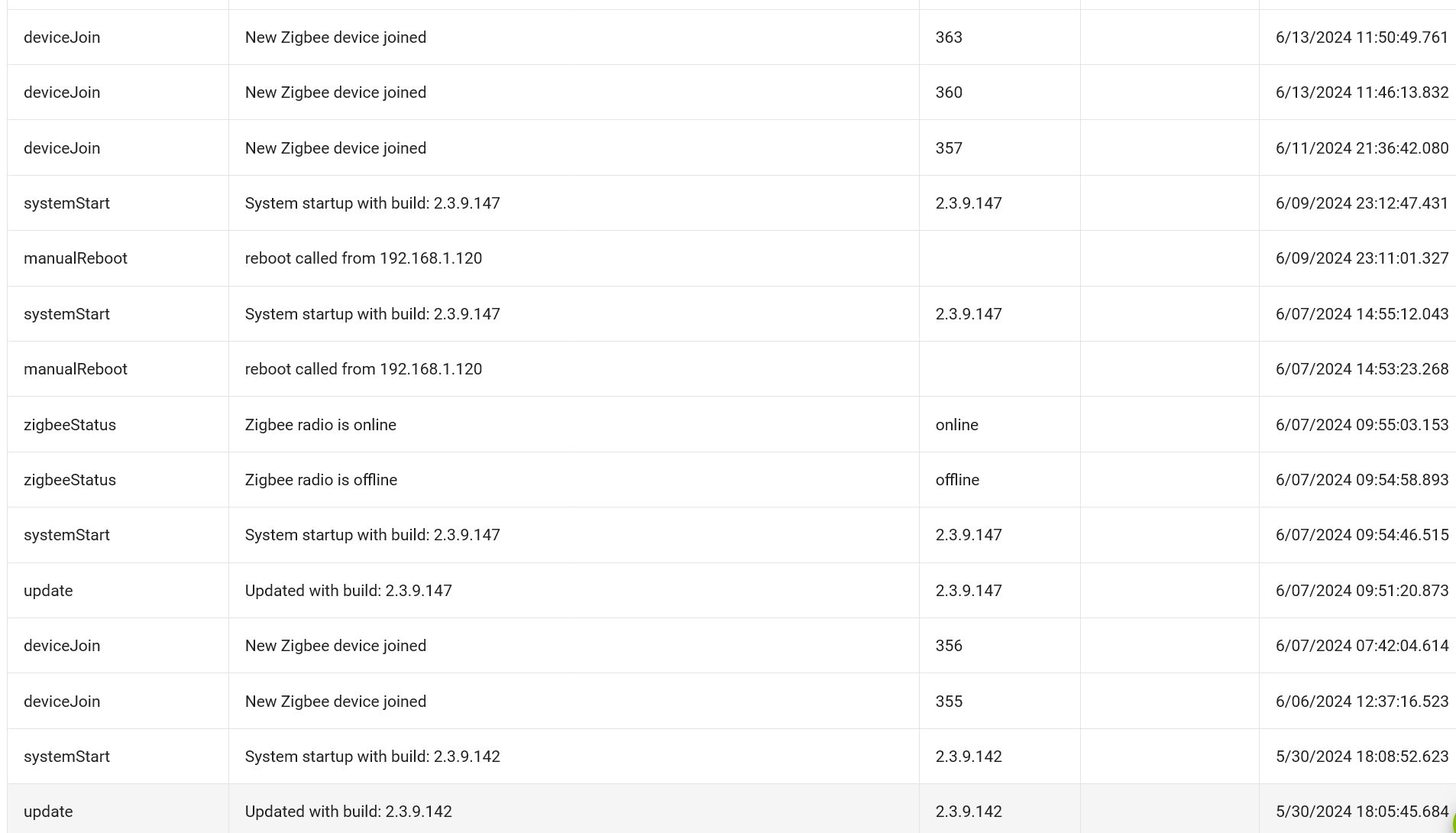

Holy smokes, I lost contact with this outlet back on the 7th and somebody's been using the button on the outlet to turn it on/off unbeknownst to me so I didn't realize it was not communicating. When I try to re-pair without taking it down to a factory reset it is not recognized. Might have to factory reset. But what derailed it in the first place. Like others have said, these have been pretty reliable.
Last Activity At 2024-06-07 12:28:51
I knew I was having some problems around the time I did a couple HE upgrades and added an INNR outlet.
Note the Zigbee radio going offline on the 7th just after restarting after the .147 update. Doesn't seem like a normal startup thing to me.
EDIT ADD: OK, did a factory reset and re-paired it. Was recognized and now works as it should. I have no idea if this was perpetrated by the HE upgrade or the INNR SP244 installation. OR, here's a thought....I am using this Sylvania outlet on an AC that's probably pulling almost 5 amps. That's 1/3 the outlet rating...but maybe there's some heat buildup that isn't being tolerated well with age.
