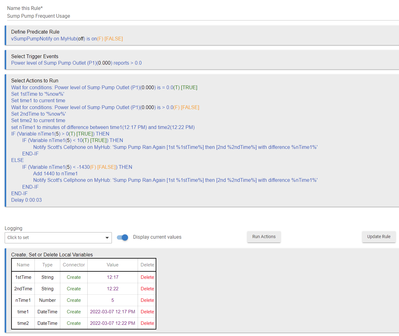

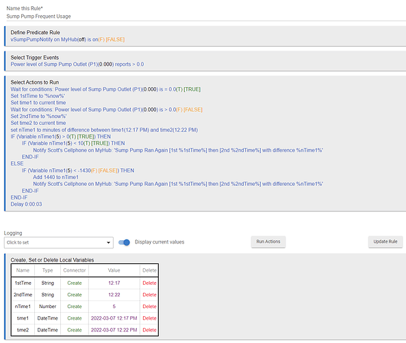

I use this as my sanity check that the sump pump is indeed working on raining days. I have an over-ride switch to prevent the notifications when heavy rain sets it off frequently.
Separately, I also have a Rule for a daily count of how many times the sump pump runs. It is displayed on my main dashboard. I have it graphed using Hubigraph. :slight_smile:

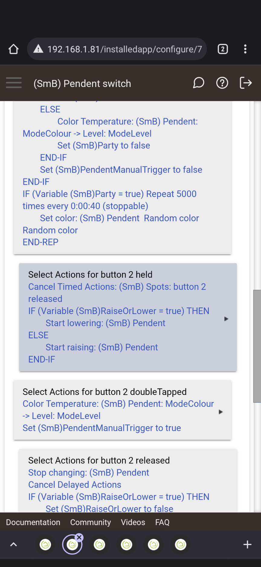

Room condition changes depending on the blind to know if my girl is in bed.

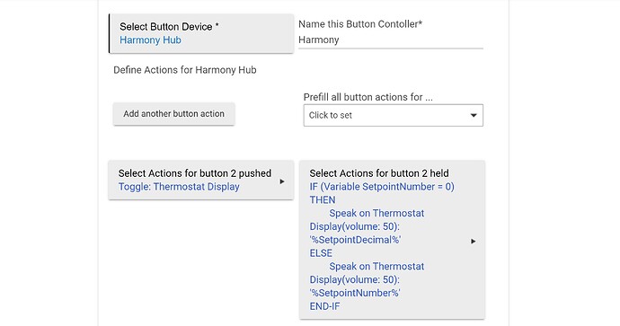

I linked my virtual thermostat to the home control buttons on my Harmony remote.
Pushing button 2 toggles the bedside tablet on/off
Holding button 2 announces the current setpoint.
Pushing button 3 increases and announces the setpoint.
Holding button 3 toggles the aircon on/off.

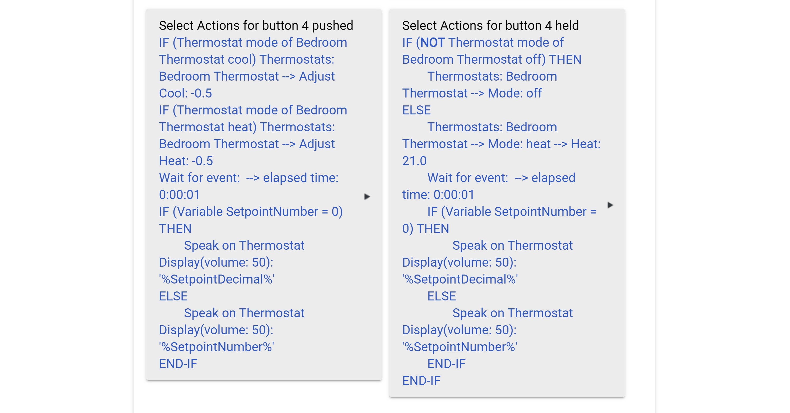

Pushing button 4 decreases and announces the setpoint.
Holding button 4 toggles the heater on/off.
I added the 1 second wait so it only announces once after multiple pushes.
I also created a rule to allow both decimal and number variables, this way the setpoint is read aloud as a whole number or a decimal accordingly (hearing 21 point zero bugged me)

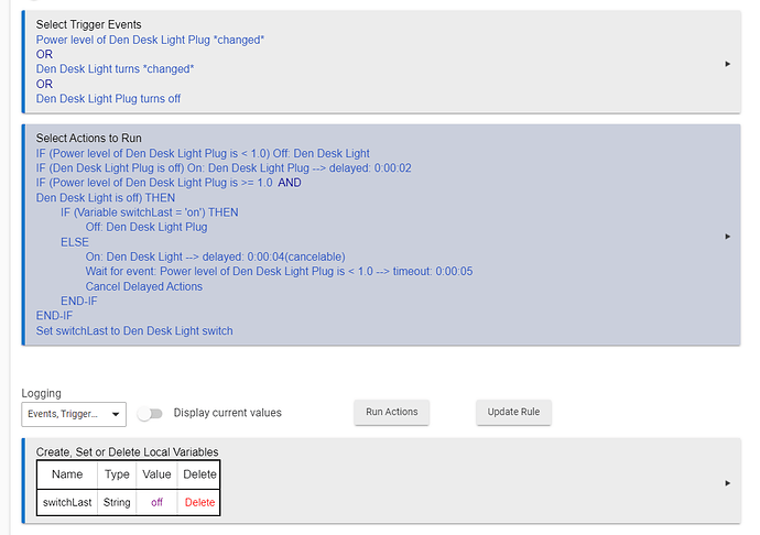

Have a desk lamp that has to be turned on manually via touch controls on the lamp. I made a virtual switch for its state and use this rule to figure out if it is on or off based on the energy reporting.
