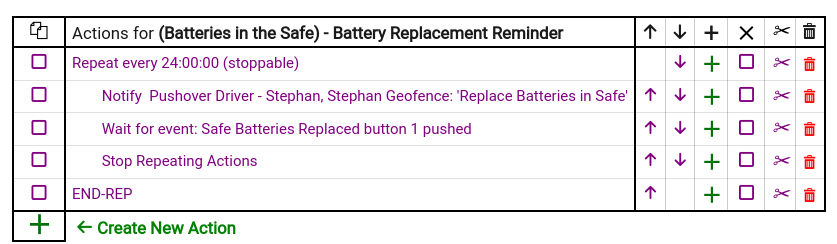

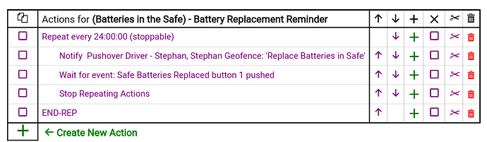

Does anyone know if my rule is suppose to look like this (Option A):

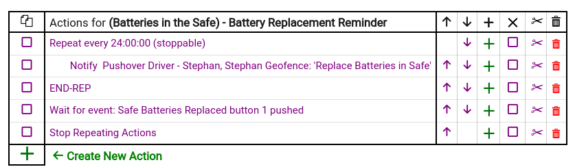

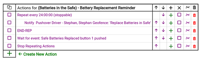

Or like this (Option B):

I don't think either will really do what you want. Option A is not correct, as it will just keep repeating the notification every 24 hours. There is no way out of the loop.

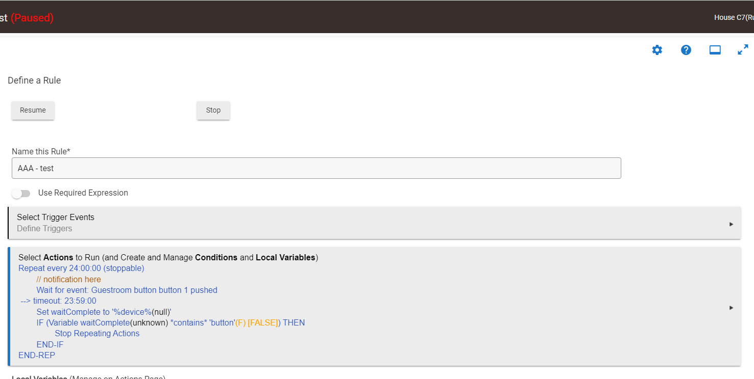

So Option B might work , as I am not sure what will happen on each loop. The wait will not continue until the button is pressed since you have no timeout on the wait. I am not sure if on the next 24 hour loop if it will go again or que up another instance of waiting for a button press.
You could add a timeout of 23 hours and 59 minutes to the wait. Then look at %device% after the rule exits the wait. If %device% is the button, which means it was pressed, then do the stop repeat, otherwise do nothing and the loop will repeat.
There are other ways as well but that is one possibility.
I agree that option A will not work.
Option B will technically work but I believe you will get a new wait ‘waiting’ every 24 hours as already stated.

This should work and would be a minor update to what you have. waitcomplete is a local string variable. If the wait times out %device will be equal to "timeout", otherwise it will be equal to the button you pushed.

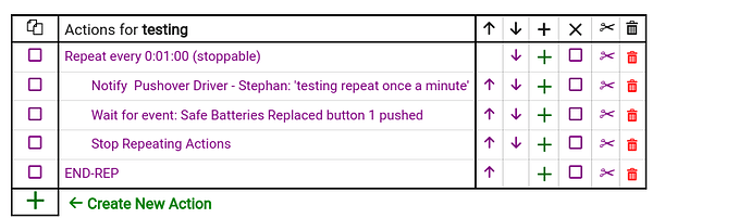

Alright, I did a simple test and created virtually the same rule as "Option A" and "Option B". As confirmed by @terminal3 and @steve.maddigan "Option A" does not work (repeat never stops).
"Option B" works exactly as intended and the push of the button stops the repeat. Thanks everyone for your help. Here is the test rule that worked:
I ran this rule several times, after only 1 message sent (no repetition), after 5 messages sent (4 repetitions), and after 10 messages sent (9 repetitions). The button press always stopped the repeat.
I thought it might work and I just tested it myself, and you are right it does.. The only thing that worried me about that approach was if multiple waits are being queued up. When the 24 hours are up if the button has not been pressed then it is still at the wait. A new rule trigger cancels a wait, but I wasn't sure if a repeat would. It appeared from the log that it did because when the wait is terminated by pushing the button it only had one instance of a stopped loop.
Since it is a 24 hour loop I doubt it would ever be an issue anyway.
This statement articulates the essence of what may be troublesome about "Option B". It works, but I share your concern about every repeat creating a new wait and therefore ending up with multiple waits. Hopefully, there is nothing wrong with this approach and everything will stay stable.

In one sense they do create a growing queue. But it's irrelevant. Each one is for the same event, so when that event finally happens, it only causes the last wait to be completed.
