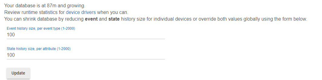

Where is the page that has the ability to set event and history globally?

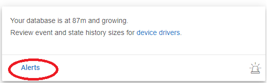

Never mind it was hidden here. If you just click on the tile you get the even logs, if you click on Alerts you get the page
I remember reading that if you are seeing the message that your database is growing it would take you to an option page to set the history of events and states globally, or has that feature been removed? Or am I imagining that I did see it :smile:
Think it's hidden unless you get the growth message, but you can access the global set using:
http://hubIp/hub/advanced/maxEventAgeDays/nnn
http://hubIp/hub/advanced/maxDeviceStateAgeDays/nnn
http://hubIp/hub/advanced/event/limit/nnn (don't go below 11)
http://hubIp/hub/advanced/deviceStateHistorySize/nnn (don't go below 11)
