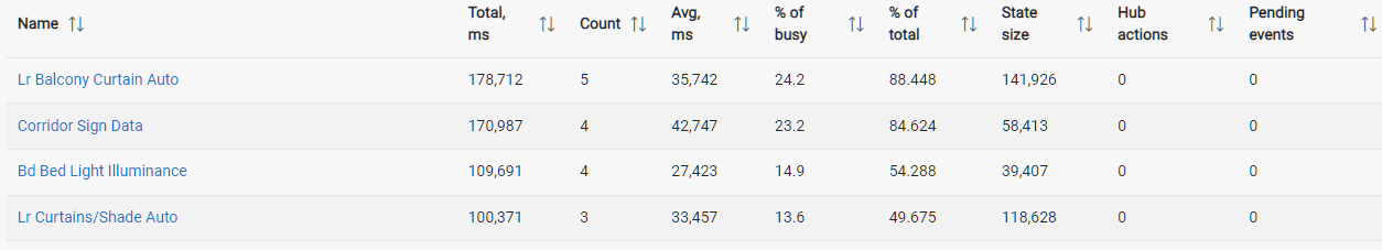

Here is an App stats right after the reboot (few very first high load aps):
I am very confused what I am actually seeing and how to interpret this data.

Here the App stats after warning popped up:
Average time hub spent processing each app's method (**Avg, ms** column)
Your Average MS column shows a severe problem. 51,448 AvgMS is almost a full minute. 60,000 would be 1 min eactly... and you're showing 5 Apps where each is 25 seconds or more PER RESPONSE.
% of total is 250% ?? One app is using 2.5 CPU cores of the 4? and you have 5 showing that EACH are using more than 24% of a core?
On my busiest hub, here's my top 5:
Screenshot 2023-04-03 at 3.41.11 PM
I'd go into your Apps page and disable those 5 right away just to see if there's some vicious cycle going on. Wait 30 mins and see if that Severe Load goes away.
