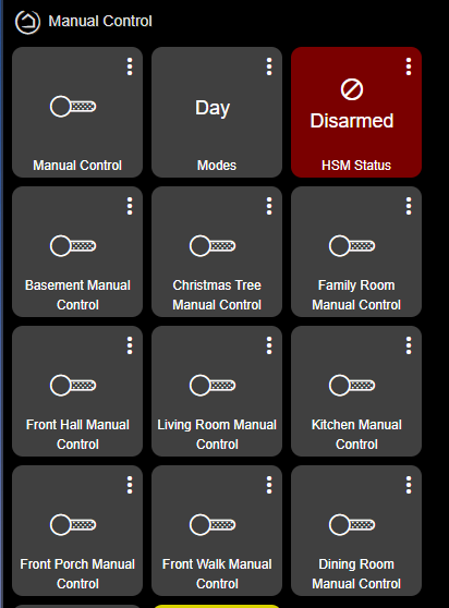

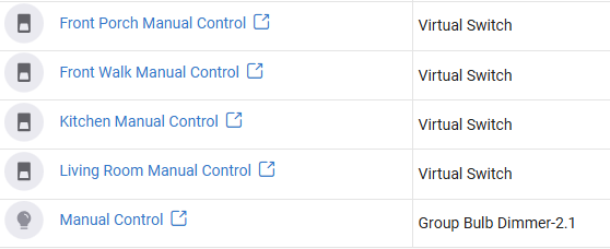

I handle this problem generally for all my automations by having a set of virtual switches called Foo Manual Control, each controlling a different area of the house. This way I can turn off automations in various areas without affecteding other areas.

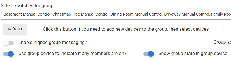

Manual Control itself is a Groups and Scenes device that just lists all the various virtual switches. This way, if one individual switch is turned on, Manual Control gets automatically turned on. And if I manually turn on Manual Control, then all the virtual switches gets turned on. E.g., it turns off all automations.
I then use each of the virtual switches in Rules and other automations to disable each thing.

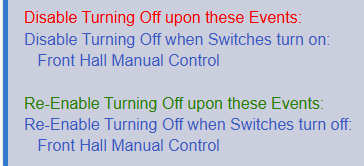

E.g., some lights are automated, but when we have the book club meeting in the house, we want to keep those lights on all the time. Thus, in that case, I turn on Front Hall Manual Control and disable the Room Lighting it is used in:
And in Motion Lighting:

I expose them all to Alexa so I can say "computer turn on Living Room Manual Control" or I can use a quick dashboard:
