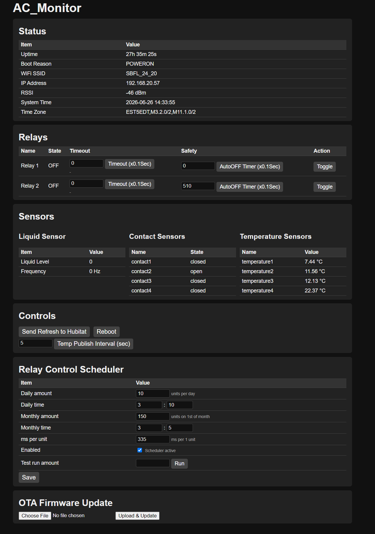

This DIY Device is a configurable (at a compile time via config.h file) which currently supports number of Relays (Switches), Contact Sensors, Temp Sensors (DS18B20 OneWire) and very unique multilevel liquid sensor:
The Device has a local Web UI interface:
Each Relay has an individual run time configurable Auto OFF and Max ON Timeouts. Realays could be locally controlled (configurable at a compile time) by Contact Sensors or Liquid Level Sensor. And there is a Real Time Scheduler for controlling a selected Relay locally.

Home Assistant picked everything automatically but HE required a custom drivers. HE was seeing everything correctly but it was impossible to created a mapping.
WebUI, HA and HE are 100% synchronized. I.e. any of them can control a Device and all are seeing a correct status instantly.
