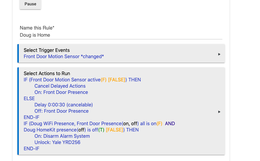

Rule 1: When the motion sensor at my front door changes state, the rule checks to see if it's active. If it is, it cancels any delayed action that might already be counting down in this rule and flips on a virtual switch named Front Door Presence. If the motion sensor state changes, and it is not active, then it waits for 30 seconds before turning off the virtual switch Front Door Presence.
Why? Because I have a hacked Xiaomi Mijia motion sensor at my front door and it resets to inactive every 5 seconds. I want to have the sensor check for status quickly, but I don't want it to stay active for too long, But I also want it the react again to presence quickly and make the state active again, without having to wait 30 seconds for the sensor to go inactive before it will detect anything again.
So the rest is pretty self explanatory, but it helps to understand that the conditions are not virtual presence devices, they are all virtual switches. IF Doug WiFI presence is ON, Front Door Presence is ON, and Doug HomeKit presence is OFF, THEN a virtual switch that disarms my alarm system is turned ON for 1 second (this is the trigger for another rule that disarms two different alarm systems to it just needs to be ON briefly) and then unlocks my front door.
Why the virtual switches? Our WiFi presence is a feature of my TP-Link Deco M5 mesh router that uses IFTTT. When the MAC address of a specific device joins the WiFi network, it turns on an HE virtual switch specific to the device. And in HomeKit, you cannot control a virtual presence device, but you can set a HomeKit Automation to turn a virtual switch ON when you leave the geofence, and OFF when you arrive back inside the geofenced area. I can remember exactly why I chose to trigger based on that switch being OFF instead of ON, but I think it was something to do with a rule I added to prevent the unlock rule from triggering and unlocking the door if one of our phones (who am I kidding - my Wife's phone ) goes completely dead and then she charges it when we're home. What was happening is as soon as the phone turned on again, it was changing the HomeKit presence as if she had just re-entered the geofence, and if someone happened to be standing at the front door when that happened, since her phone was also on the WiFi, it would unlock the door when we didn't want it to.

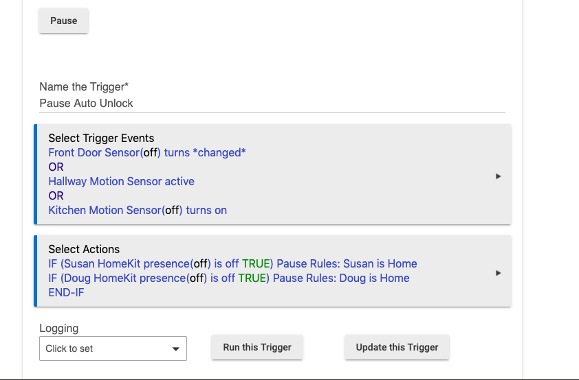

Rule 2: To prevent accidental auto unlock as I mentioned before, this rule looks for a change on the front door sensor, or active on the two first motion sensors we hit when walking into the house in case the front door sensor or one of the virtual switches is out of sync or something hasn't responded for some reason, and we have to manually enter the code. If our HomeKit presence indicates we are in the geofenced area, then upon triggering, it pauses the rule so auto unlock cannot happen.
It probably should also stop the lock from opening because it pauses the unlock rule, based on who has arrive inside the geofence, but it doesn't seem to interfere, and the unlock rules don't activate again until after the next rule unpauses them again. Timing I guess.

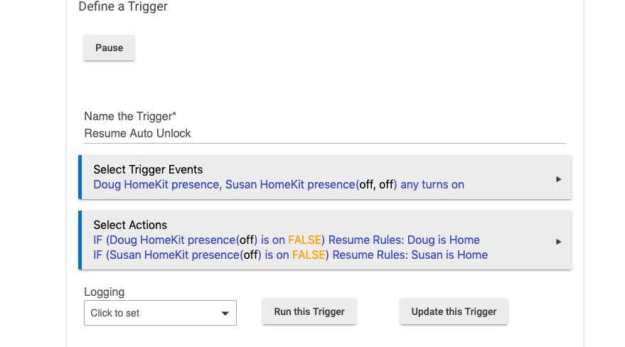

Rule 3: This rule reverses the effect of the previous when we leave the geofenced area. It then resumes our individual unlock rules so they're ready for action the next time we return.

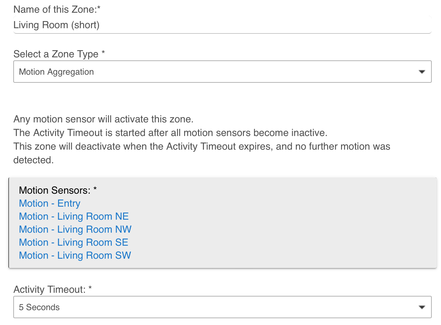

I did something similar but I change the duration based on modes. First I setup two motion zones using the same sensors (Iris v2). I have a short zone trigger set to 5 seconds after motion stops and a long trigger set to 10 minutes.
I use these to control how long the lights will stay on based on mode.

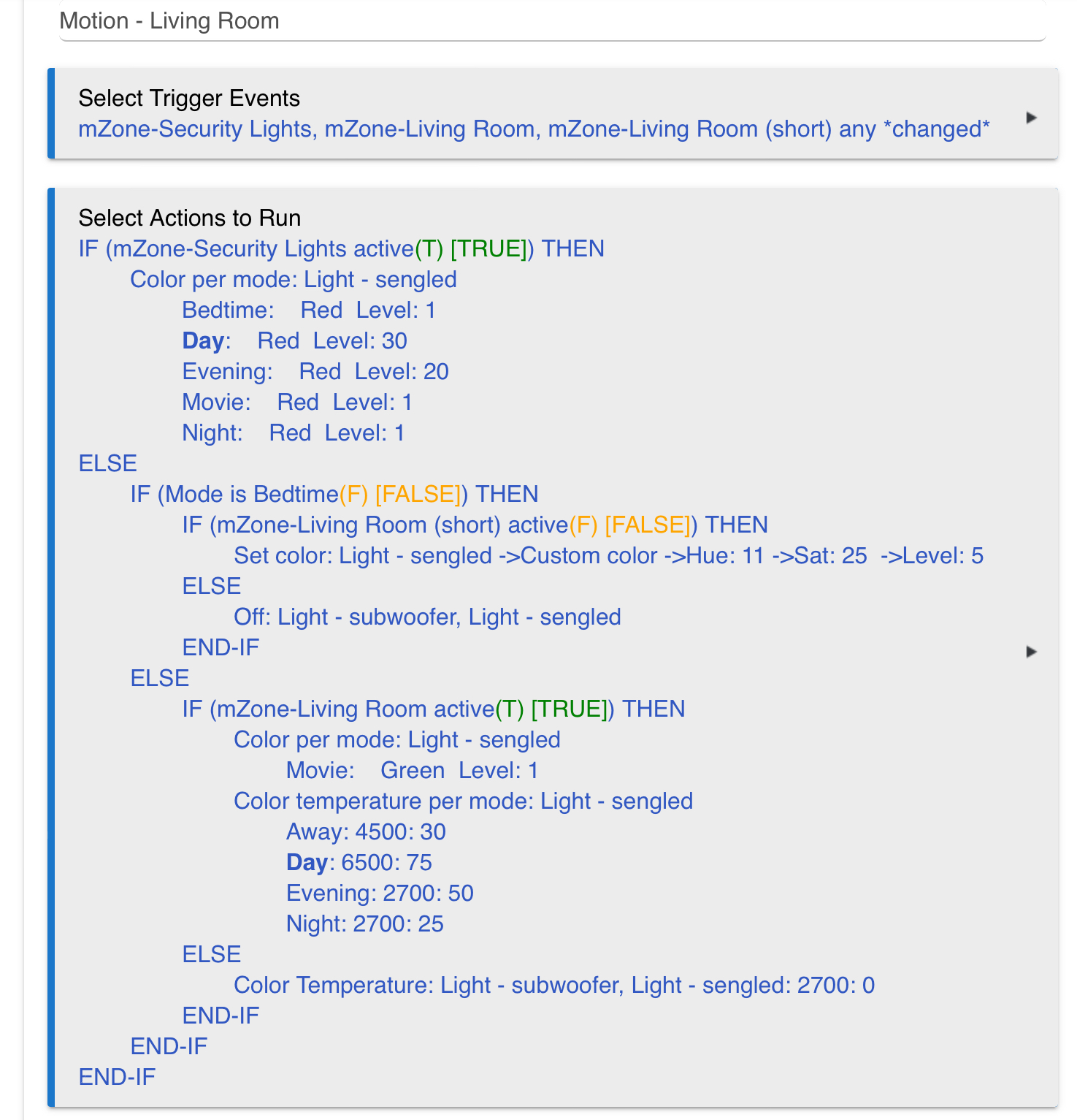

You can ignore the first if. I’ve been using my outdoor sensors to test triggering the light.
So basically what it is doing is using the short trigger if the mode is set to bedtime, otherwise it uses the long trigger. Then within the activation section I further set the lights based upon the mode.
I’m still fiddling with it so the colors and levels aren’t dialed in.
I also have another similar rule that adds a Pico switch override and will eventually include a contact override as well. Lots of ways to accomplish the magic.
