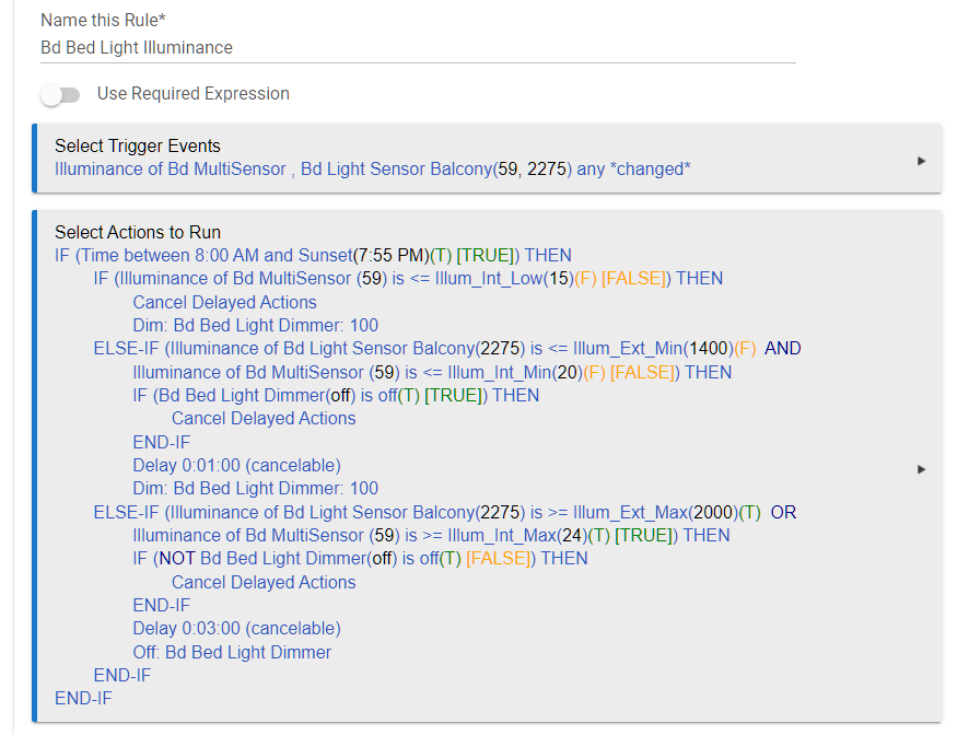

I am seeing these errors in a log:
What could be wrong with this rule:

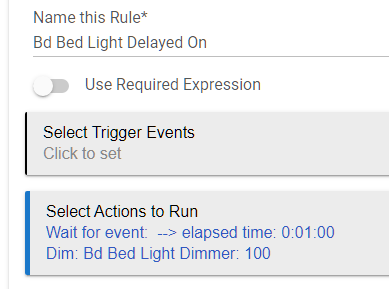

Recently I actually modified this rule by replacing "wait for event : elapsed time"
statements with cancelable Delays. The reason is/was: I don't want to
retrigger Delays if the Delay already started.
Actually rule is working as expected but apparently I introduced a problem.

Not causing your issue (I don't think) but you should move the time constraint to a required expression. Right now, the rule will run every time the lux changes. Since you don't care about lux changes outside your time window, the required expression would verify you are in the time window before actually processing the rule.
I'm wondering if having both sensors as a trigger is causing the rule to be trigger twice at the same time. Meaning both sensors see a change in light because of a cloud and it causes the rule to kick off twice within a few milliseconds of each other.
You should be able to see this thread, and this post in particular, with some discussion that also appears to be the problem in your case:
https://community.hubitat.com/t/2-3-2-115-log-error-for-rm5-1-rule-c7/94162/17?u=bertabcd1234
For everyone else (who isn't in the beta group where this was first discussed), the issue occurs if you have a delay inside an IF THEN and another execution of the rule starts while that delay is still pending and then that IF THEN is reached again (regardless of whether it evaluates true or false; just if it is reached at all--it has to be evaluated either way). There isn't inherently anything wrong with a delay inside these conditional actions, just if/when they are reached again. You would have gotten an error previously, too (this phrasing is new in Rule 5.1), just a more cryptic one.
An easy way to prevent rule re-entry is to set Private Boolean false as your first action, set it true as your last action, and add a required expression that Private Boolean is true. There are other options, depending on what you want, Breaking this into multiple rules might also make things easier to work with.

Honestly, I have no idea what your rule is supposed to do--or, even if interpreted literally based on your rule actions provided, if it would truly work as you expect 100% of the time. So, I might start with a plain English description of your goal, then someone can work from there.
I have questions...probably more for my edification than anything else. I loosely re-wrote your rule in pseudo to get rid of the white noise. Commented in-line with the questions.
IF ("bed lux" <= 15) THEN
	Cancel delayed
	Set "bed light" to 100
ELSE-IF ('balcony lux' <= 1400 AND 'bed lux' <= 20) THEN
	// Is this actually needed? Isn't the bed light going to get turned on in a minute regardless? Unless the LUX changes during the 1 minute wait I suppose.
	IF ('bed light' is OFF) THEN
		Cancel delayed
	END-IF
	Delay 1:00
	Set 'bed light' to 100
ELSE-IF ('balcony lux' >= 2000 OR 'bed lux' >= 24) THEN
	// Same as above. Is this actually needed? Isn't the bed light going to get turned off after three minutes regardless? Unless the LUX changes during the 1 minute wait I suppose.
	IF ('bed light' is ON) THEN
		Cancel delayed
	END-IF
	Delay 3:00
	OFF: 'bed light'
END-IF
My read is that your use-case is:
  • If it's dark in the bedroom, turn the bed light on. (Early dawn/late dusk/thick cloud coverage)
  • If a little light and stays that way for at least a minute and the light is off, turn the light on. (Late dusk/thick cloud coverage)
  • If it's pretty bright and stays that way for three minutes, turn the light off.

What about:
Make the time window a required expression.
Set "Cancel delayed actions" as your first action and remove if from the rest of the rule.
