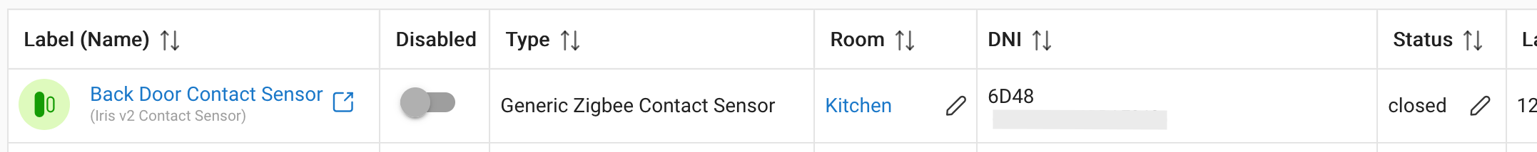

Working for me:
What do you have selected for the "Default current state" preference (previously "Status attribute for Devices/Rooms") on the device? This is also accessible with the pencil/edit icon you have turned on for this column. (See: Devices | Hubitat Documentation)

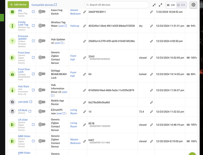

ok more info.. figured out i had to set the default state/attribute..
most now show in list mode..

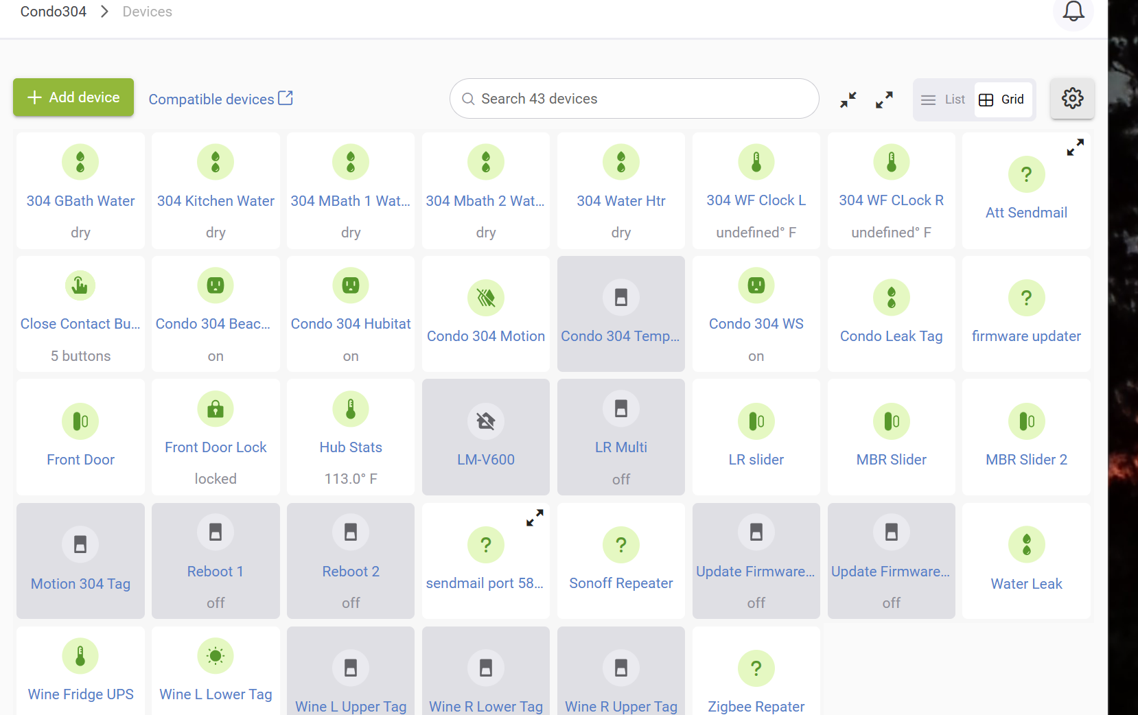

but some that show in list mode don't show (see front door, lr slider etc) . in non list mode., and others (see wf with clock) show as undefined when not in list mode,.
This column is only visible in list mode and the preference only applicable to that.
Grid mode shows a pre-selected status based on a hierarchy of built-in capabilities (and is, in general and as in the past, less customizable than the list view), similar to the home and Rooms pages, at least for now.
definately a bug there in grid mode with contact sensors the default should be the contact and if not that the (temp) as these are default zigbee contact sensors with temp.. front door, lr slider etc .. should not be blank.. my opinion should be the contact state.

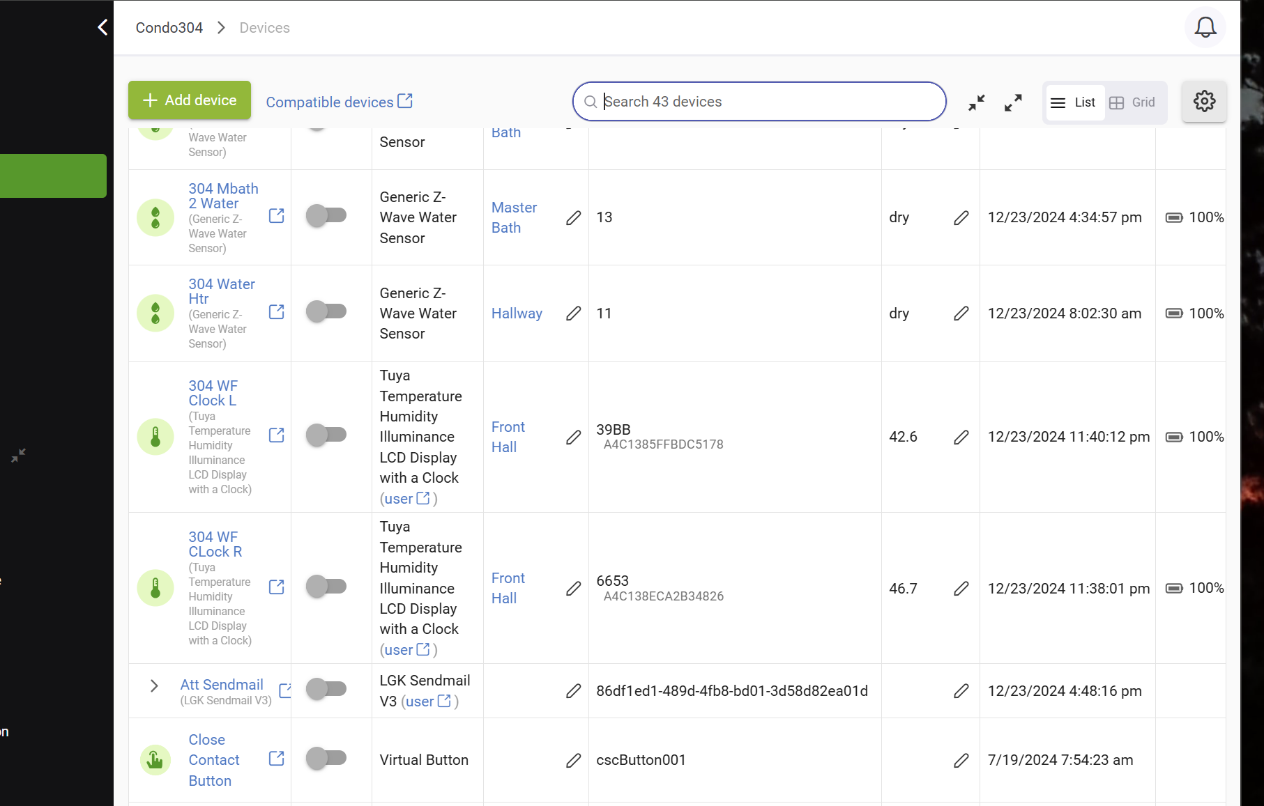

also the zigbee clock should not say undefined temp.. i believe that is also a bug and it is not handling the decimal possibly,
same with motion sensor should default show the motion attribute..
i guess motion, and contact are just not handled yet in grid mode?
