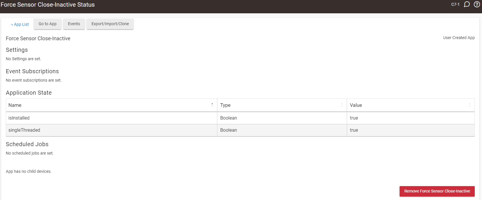

Thanks - it's working on my C4 and now I have a problem on my C7 because the older verision is apparently still in use by something but I dodn't know what. Any way to force delete the older app code?
skip it - I think it is fixed now
