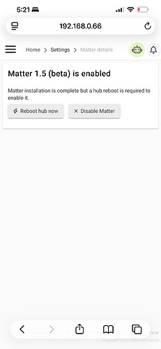

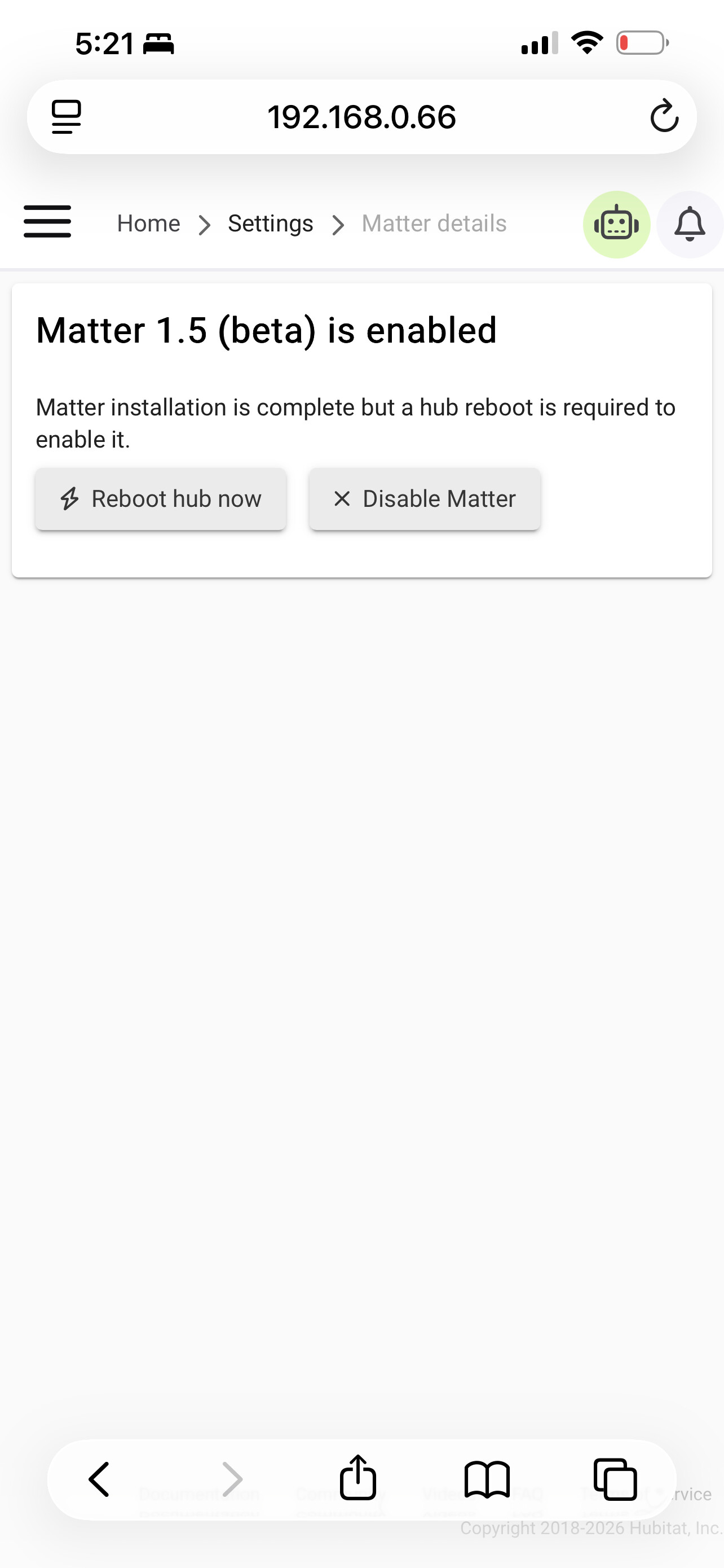

Hmm, got the same issue today with my Kajplats. After a reboot of my HE everything works again.
Starting to suspect that the latest FW causing this since it worked flawless before the update. @kkossev have you notice any strange behaviour with Matter after the latest FW?
I don’t know if this is related to the latest HE platform version, but in the past two weeks I had two incidents, where the Matter interface of my C-7 hub was found to be inoperative in the morning. A few hours earlier there has been an automatic hub reboot..
A manual reboot started the Matter service again, but this problem affected badly the WAF… : (

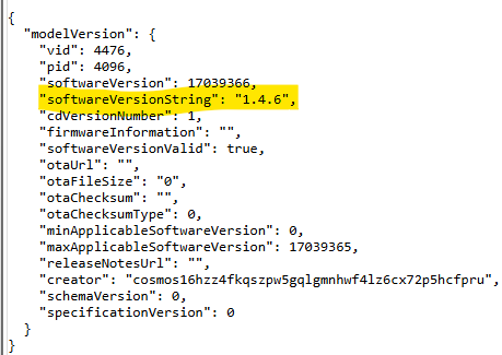

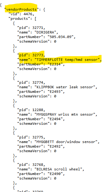

I spent some quality time with ChatGPT and found out I can get what I want just using a web browser (the result is JSON, but the Edge browser gives you an option to pretty-print):
Find all IKEA devices (IKEA is vendor 4476):
https://on.dcl.csa-iot.org/dcl/model/models/4476
Find the product you're interested in. For example:
GRILLPLATS → PID 4096
MYGGSPRAY → PID 12288
TIMMERFLOTTE → PID 32773
KLIPPBOK → PID 32774
https://on.dcl.csa-iot.org/dcl/model/versions/4476/4096
and decode the softwareVersionString:
https://on.dcl.csa-iot.org/dcl/model/versions/4476/4096/17039366
