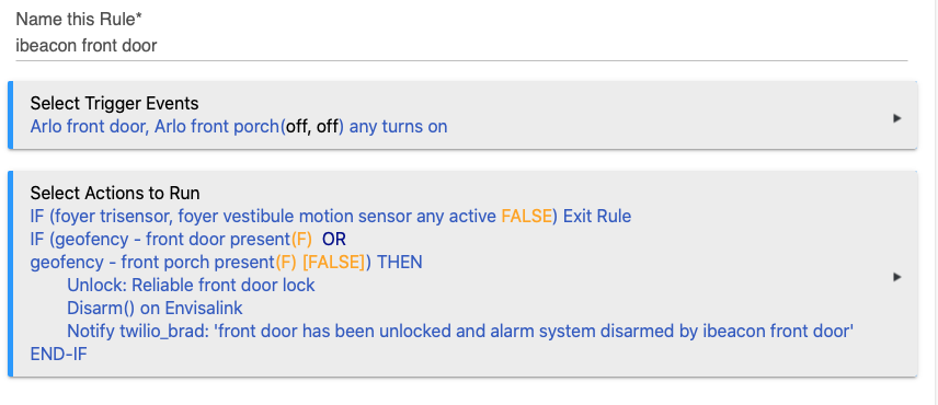

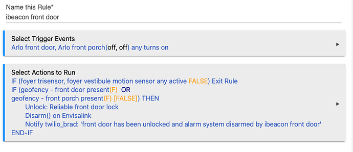

I have been playing with Geofency, the very nice integration by @brianwilson, and iBeacons. I have not quite got them 100% yet (mostly because the Geofency app itself is a little flaky) but it might be an option. I have an outdoor iBeacon on the front porch. The Geofency app detects the iBeacon and sends an alert to the hub (can be configured either as a cloud service or locally), which changes the condition of a presence device. I then combine this with motion sensing on my Arlos (via IFTTT) and presto - the front door unlocks and the alarm disarms.
Geofency runs in the background so it meets your "no interaction" requirement. The cool thing about iBeacons is you can set their range (more or less) by adjusting their power output. It is dependent upon your phone, rather than your car, so it will work regardless of what car you're driving as long as you have your phone with you. It can send data to HE either locally via wifi or via the cloud.

This is a great idea, I like the idea of needing both triggers. I'll take a look at ibeacons for other things too.
