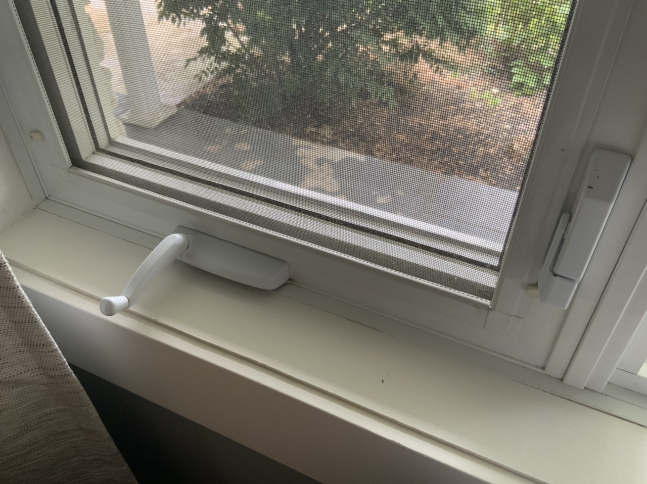

Crank type windows that lock. Oh, how I would love to be able to automate these… at a reasonable price of course…
Until then, I have a TTS to tell me or others in earshot to open or close the windows as required.

"Motorize your crank window" video
He's got too many caveats and "mostly works". Stripping the coupling, only closing to 99%. And having that big device sticking out on the window. Locally, the WAF would be very, very low.
He recommends a beefier motor and coupling than the ones he was using. Would def not use a 3d printed plastic coupling for this. I would also maybe add more screw holes in the base for the side nearest to the window.
The general concept seems good though.

Nice, though the WAF on it may not be very high… I’m concerned that if the motor provides too much torque, it will strip the gears inside the window mechanism (have had to replace one because of this…). I have seen some motors that will detect if they are applying too much force (some type of feedback?) and the board could detect this and stop turning the crank.
The other part would be the locking mechanism. An actuator would likely do the trick for that.
I wonder instead of a reed switch you could have some sort of physical contact.. where when the window closes it closes a circuit which signals the motor to shut off.
That’s a very good idea - would likely be more accurate!

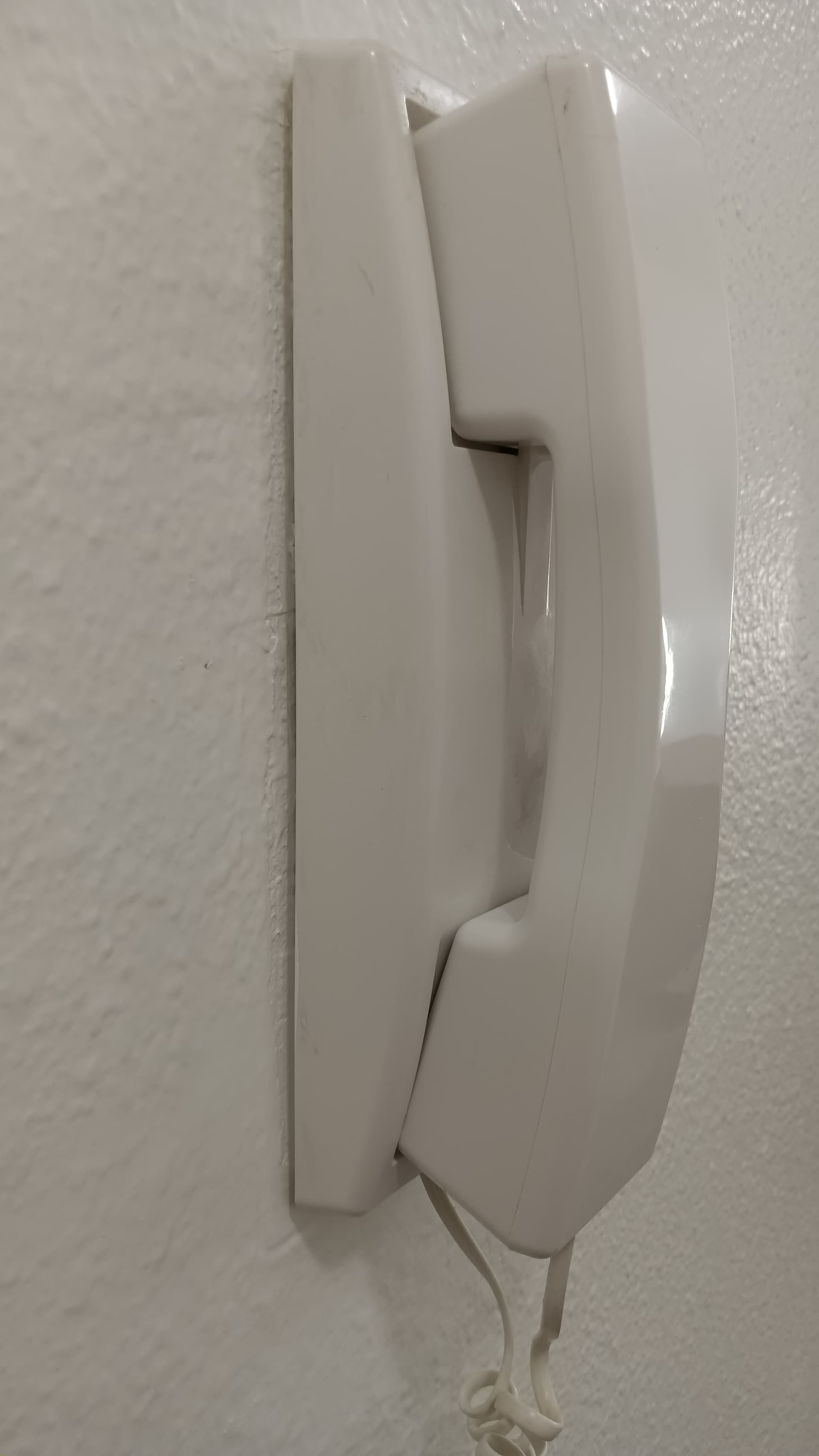

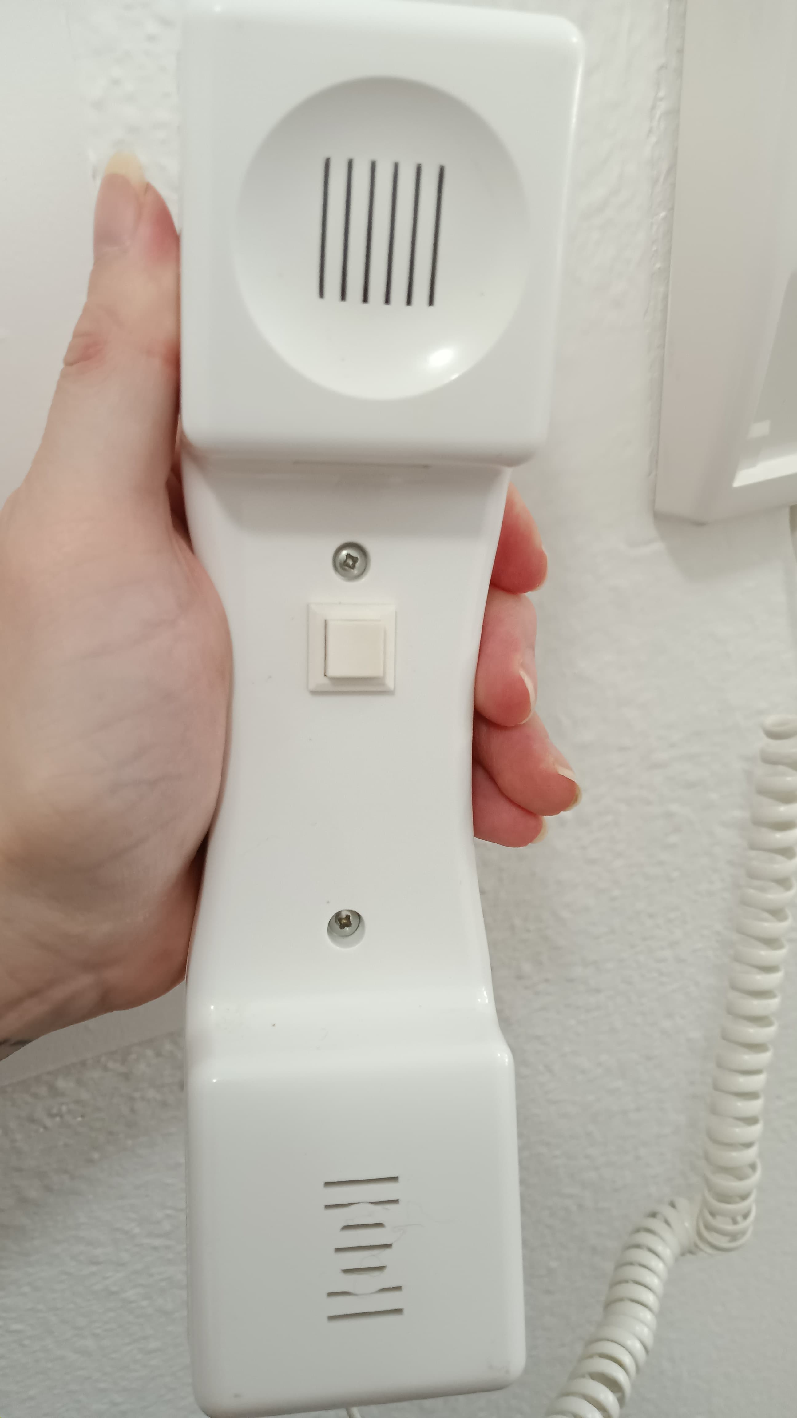

The big thing for me at the moment is my apartment's antiquated buzzer system. It's basically a wall mounted slimline phone, that you have to take off the hook and press a button.
I imagine if the phone were off the hook, you would not hear someone "calling" it to be let into the building, as well as everything going on in the apartment would be broadcast to the street, or I would just leave it off the hook and use a SwitchBot
I would love to be able to buzz someone in from anywhere in the apartment, especially if it's a delivery while I'm in a WFH meeting
