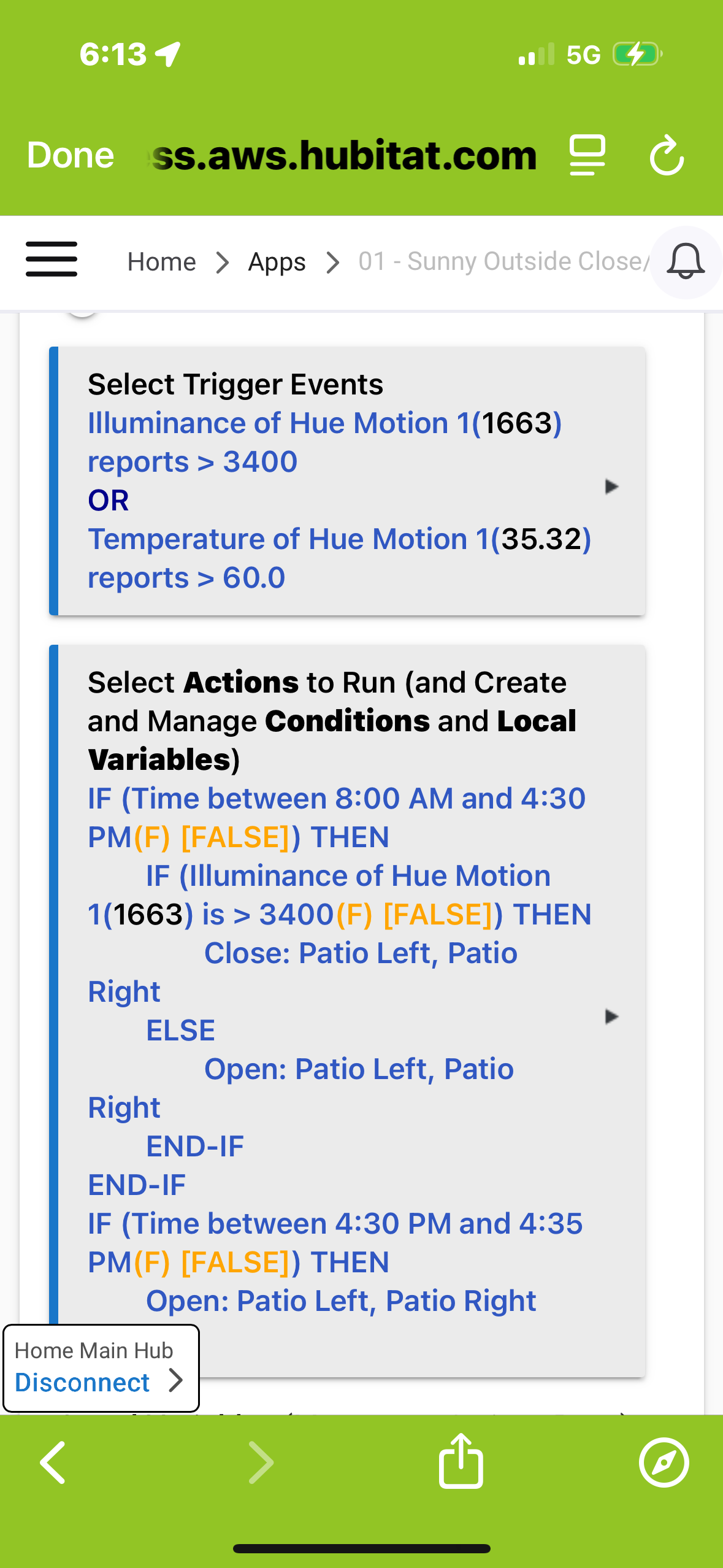

I recently wrote this so when my hue motion sensor, sense light above a certain amount, and the blinds would automatically shut on that side of the house. I only wanted it working from a certain amount of time and then to open up at a certain amount of time, here is what I wrote if anyone help would be appreciated
First I would look at your trigger. Your rule will trigger when the illuminance is 3401, but also again at 3402, 3403, etc. The same with the temp, although you don't show how you are using that. Looks like some of the rule is cut off in your screenshot. You don't really say what is does or does not do that you didn't expect.
If you only want it triggering during certain time, a better approach might be to use a required expression, or conditional trigger. The conditional triggers are fairly new and I haven't really used them much yet, but seems like a good option for this.
Another view of OP’s rule.
ETA: I’m also unsure why the Hue sensor’s temperature reports are in the rule trigger, based on what OP has said so far about intended use case.

What is your intent with that second IF statement (since it's just a 5-minute window)?

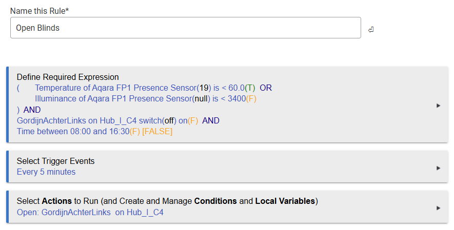

It would look something like this:

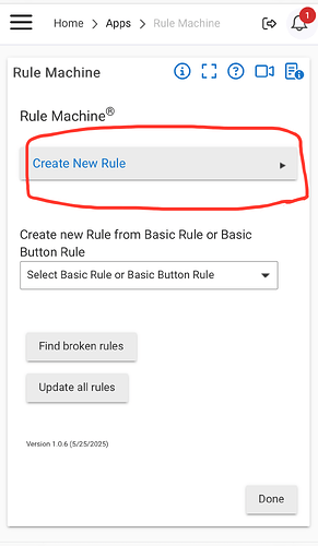

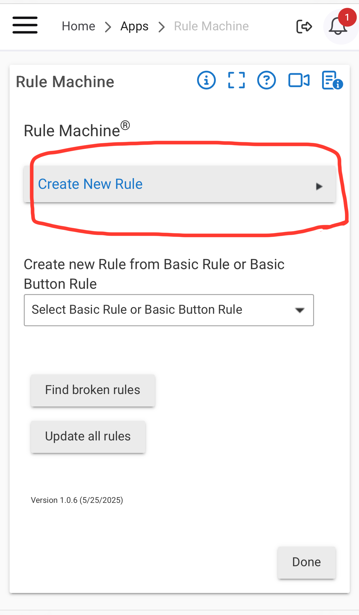

Thank you, did you right this in Rule machine Legacy rule or the new rule machine.
You might be overthinking this in some aspects.

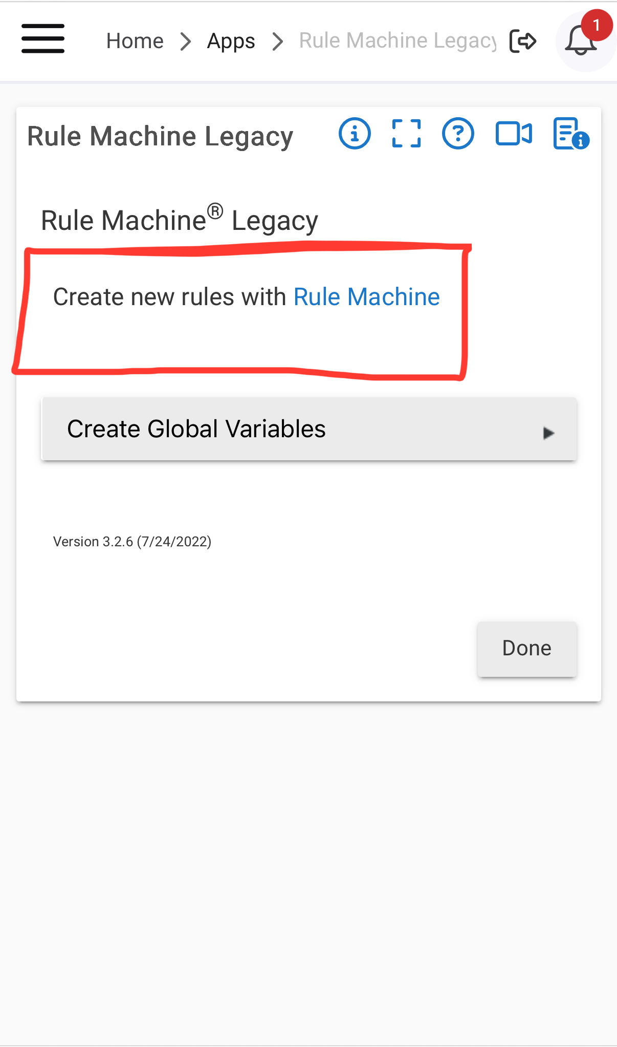

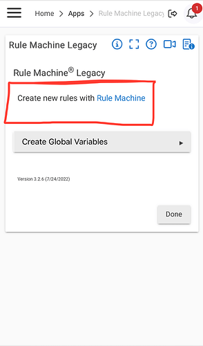

You can’t create new rules in rule machine legacy. There is even an instruction to use Rule Machine:
Just browse to “Rule Machine” in your hub’s apps list, or add it as a built-in app by clicking the button at the top of the list of installed apps (if you have never installed Rule Machine previously). Then create a new rule from there.
Ok thank you.
