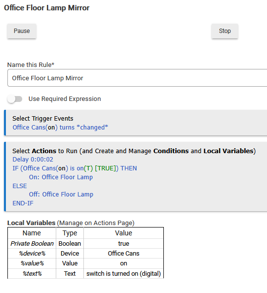

Here is my fix in the end. The problem is the "changed" condition for a trigger is unreliable with a dimmer level. For inexplicable reasons when you set the dimmer to 48 (from an off state) the trigger never fires no matter what what the prior on state was. So there must be something amiss in how the "changed" function is evaluated or some odd rounding issued that only happens at dimmer level 48..
I always prefer to have one rule for a situation rather than two, instead of one rule for positive event and one rule for the negative. It just keeps my rules tidy. So below is my fix. I trigger on the ceiling cans turning on "changed". this seems to fire whether turning on or off the light and at any dimmer level.
I could write two simpler rules to achieve the same thing but as stated I prefer to encapsulate into one rule instead. If any RM experts out there know of any warning for such a trigger condition please chime in. It works fine but I might be unaware of an unintended side effect although I doubt it.
