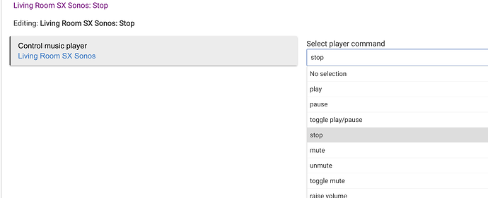

Do you have a music player installed in your system? I am not able to reproduce a problem with this action.
All I can say is that software itself is not random at all. I have never seen this happen in RM, and I create/edit a lot of rules. So, it's a mystery what would cause this. I know the code involved, and it does not do this. There has to be some user input, i.e., from the browser...
