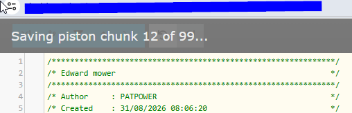

My piston is saving if the task number on the screen while saving, is under 99 if it tells 99 and I add something, it wont tell any number while saving and just return in editing mode and if I refresh all modif are lost...
Is this a normal behavior? A kind of max length piston?
Task number?
yes, this thing
if it exceed 99 nothing is shown and saving abort...

its a big piston but to me not too big... I mean, when you have multiple devices that act like trigger and action inside and you need multiple event... one device or globale reset another...another set another... etc so yes, it takes few step... webcore is simple to use but to built complexe logic its pretty long and require multiple block...
for now I just add another piston to do what was missing, hopefully it was data that can be separated from the main piston...
I made another post on it but also passed a point, you loose system variable...they are calculated...etc but you cannot add any, it dont see it. they must have been compiled before...the trick is to copy piston so they are there before you saved...
