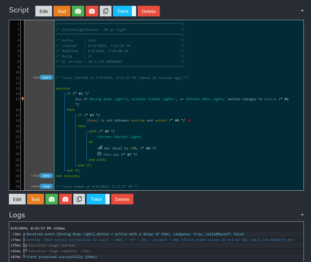

And, if I use the {$now} variable which is a "datetime" type, I don't get the option in webcore to add an offset to sunset/sunrise times which is pretty annoying! But I also tried this and it doesn't work either (and it is now past sunset):

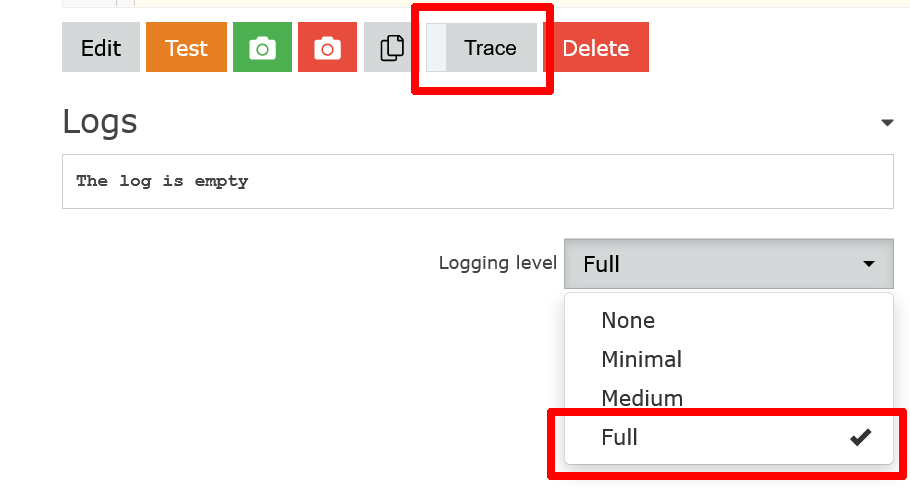

One thing that you can do to help us debug is turn logging level to full and turn on trace, run the piston, and give us that information.
Results attached after I walked by the motion sensor (this one using {$now}):
Are you sure your logs are set to full? There should be an evaluation of your second IF in the logs and I do not see it.

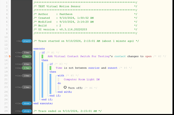

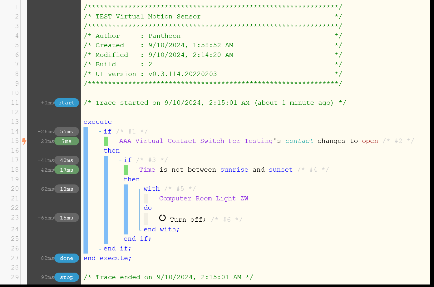

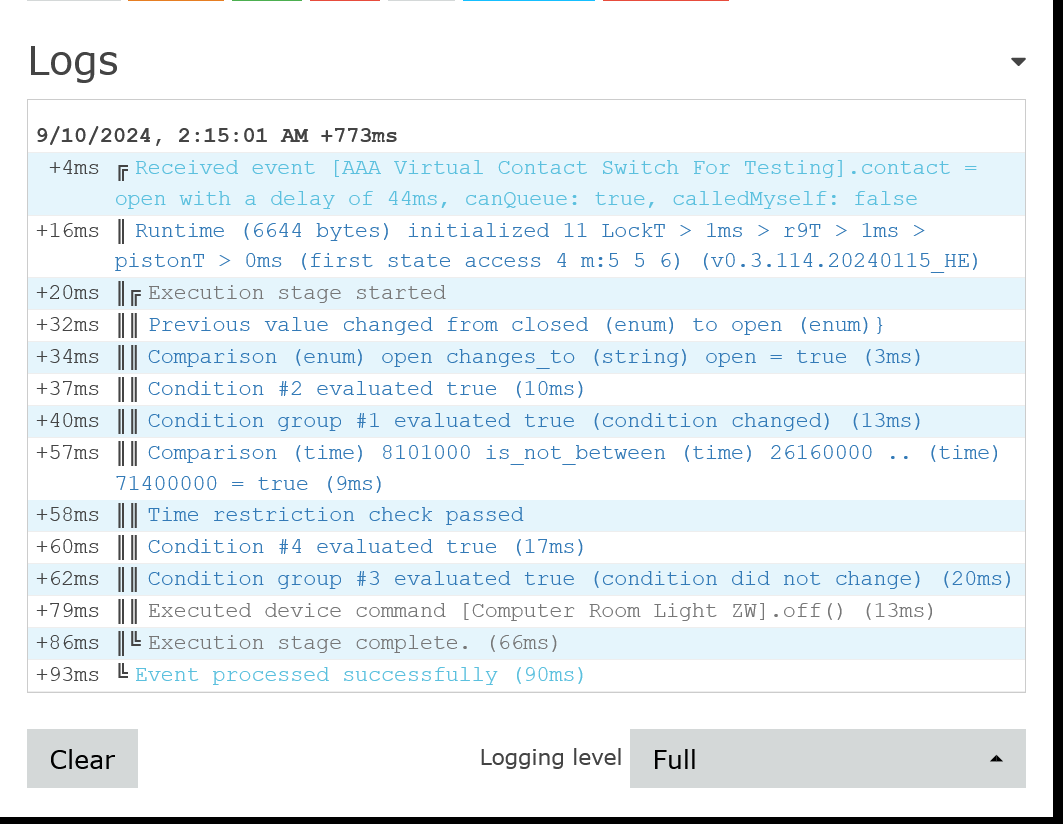

Here is my quick test piston and logs that works as expected...
