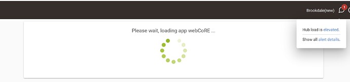

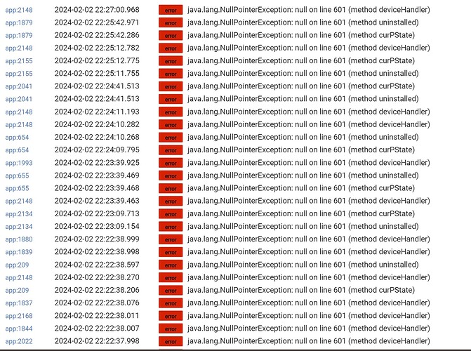

Please help. This evening I migrated from my C7 to my new C8 Pro, followed the migration instructions to the letter, but I'm unable to access webcore post the migration. I've logged out via my C7, repaired the install on the C8, tried deleting the app to reinstall then restore my pistons from my backup (but it won't let me as it says that https://raw.githubusercontent.com/imnotbob/webCoRE/hubitat-patches/smartapps/ady624/webcore.src/webcore.groovy is still in use, even with the app disabled), nothing is working. I'm getting the ring of death whenever I click on the app, hundreds of errors, and the hub load goes to severe, making the hub very sluggish to respond to even reboot requests. Any ideas how I can resolve this?

I can't access any of the webcore app settings, nothing but the ring of death in the jpg above. :weary:
