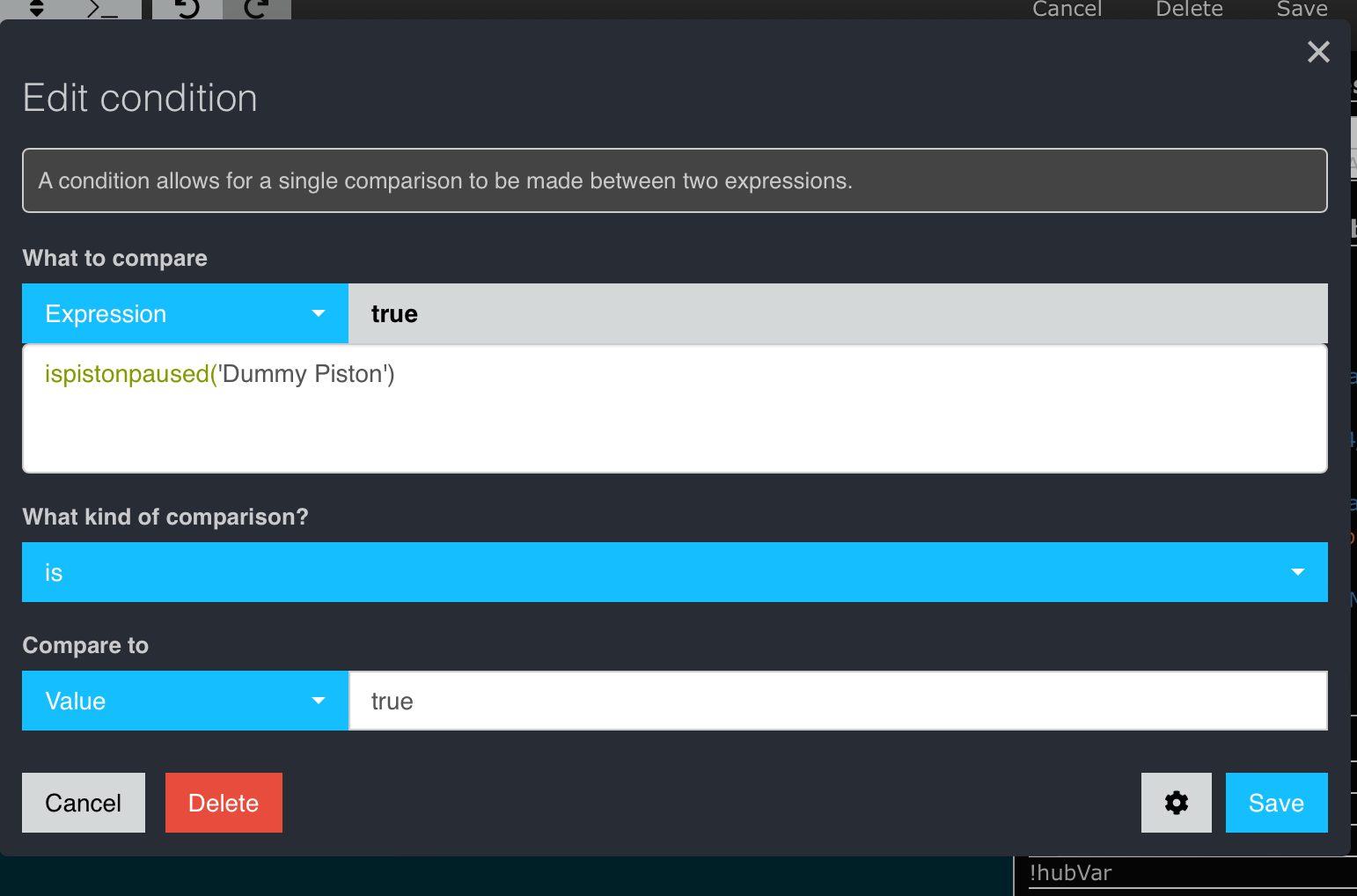

ispistonpaused('name') is a function, that you using in an expression
so if(expression) is true
then.....

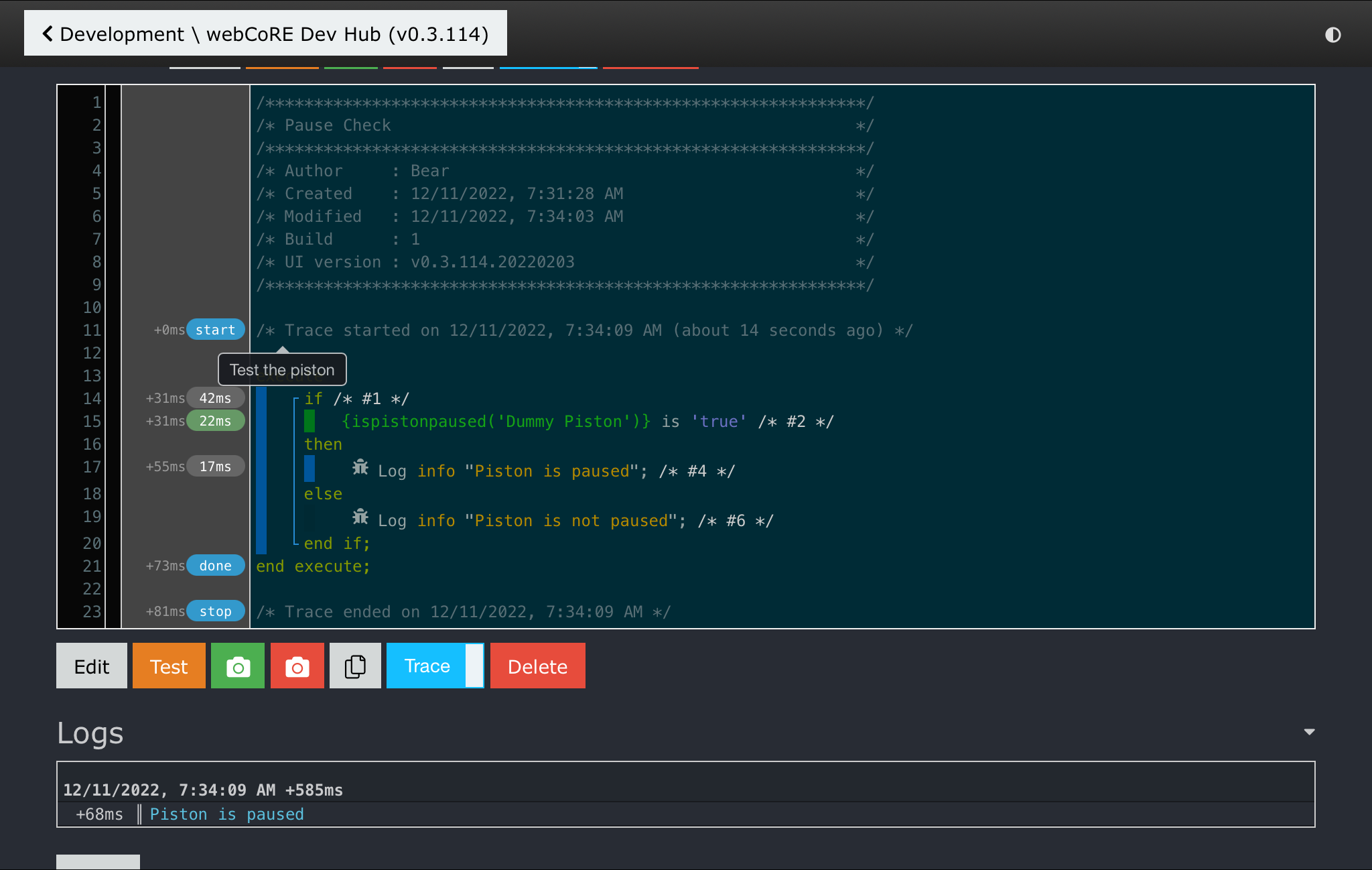

could you share with me the piston, or tell me how to find and use ifpistonpaused, I cant seem to find it. Tried for an hour last night
Use import code ucvq if you want to grab a copy or
