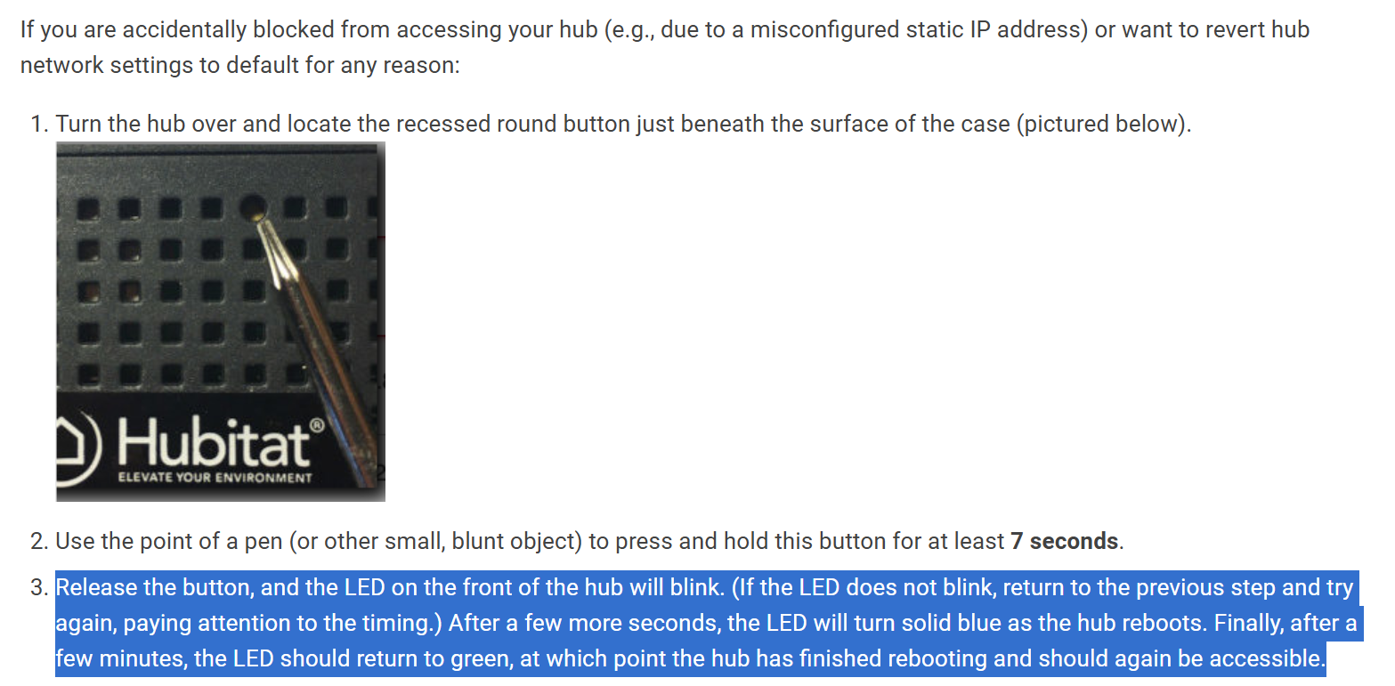

  • I tried the hidden button underneath the hub (no change)

Does your hub complete the reboot sequence during the Hubitat Elevation Network Reset procedure? :thinking:
Just want to make sure the Ethernet cable was connected to the hub when you performed the network reset procedure

Yes. Both times (before and after attempting to remove the hub from my static IP listing in the router).

First... The SSID was a little finicky because it kept disappearing from the network list on my phone. I pressed the secret button a couple times, but once I timed it right, I could connect the hub to my Wi-Fi. It picked up a new IP address.

Resetting the hub, with the hidden button, should have cleared any existing network settings. Also If that static IP was within your LAN, then your new hub should have worked fine, unless of course the old hub was still connected, resulting in an IP conflict. So it appears that something "deeper" was going on, which will probably remain as unknown.

I tried to reset with the button underneath 4 times this way, but no success connecting so that I could connect it to the Wi-Fi network. I have to head to work and can't troubleshoot until later today, but wanted to get the message added here. I wonder if there's something to make of the fact this seemed to happen a week apart (I can't say exactly a week but if it was, maybe that also helps in the troubleshooting).
